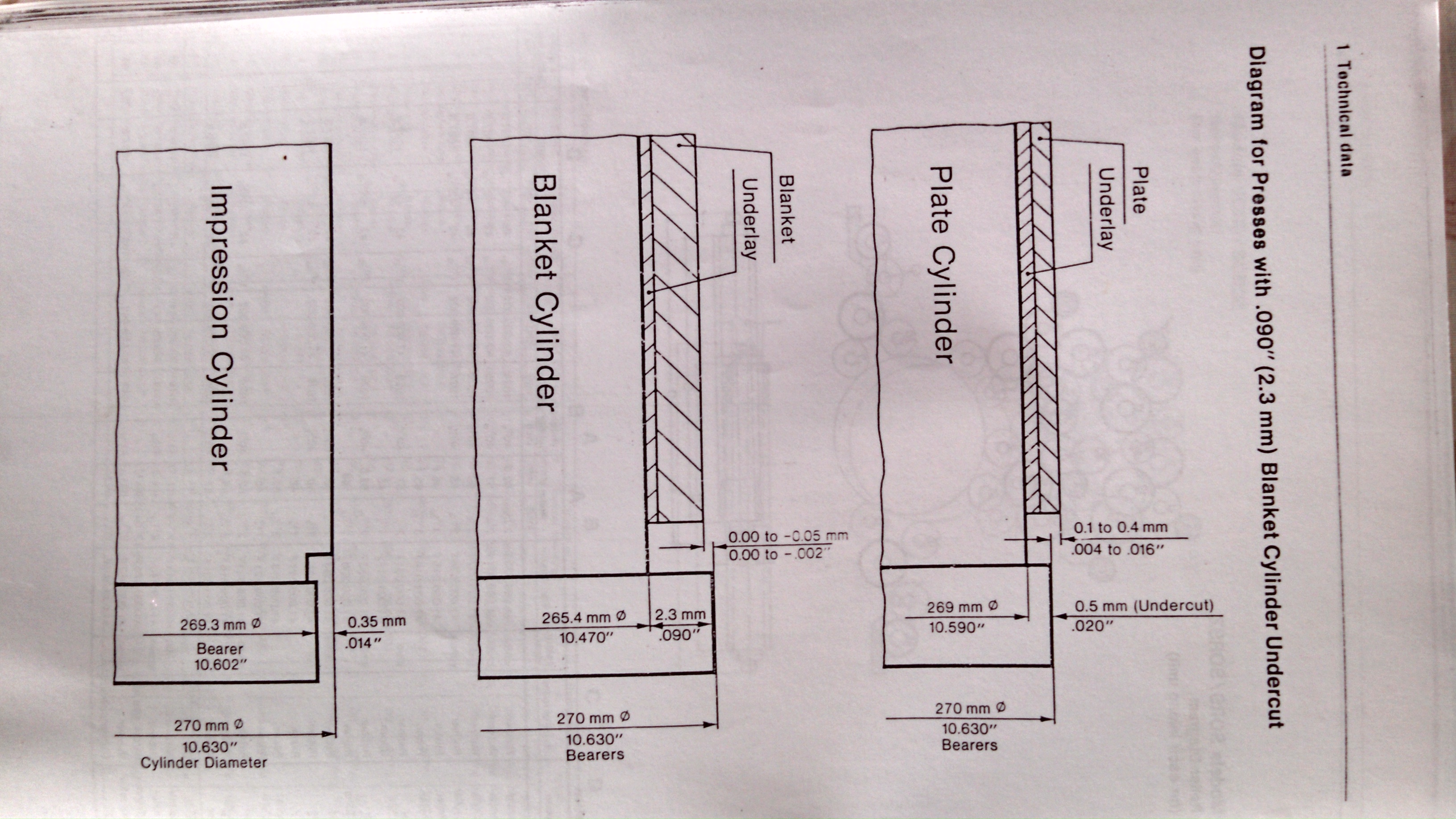

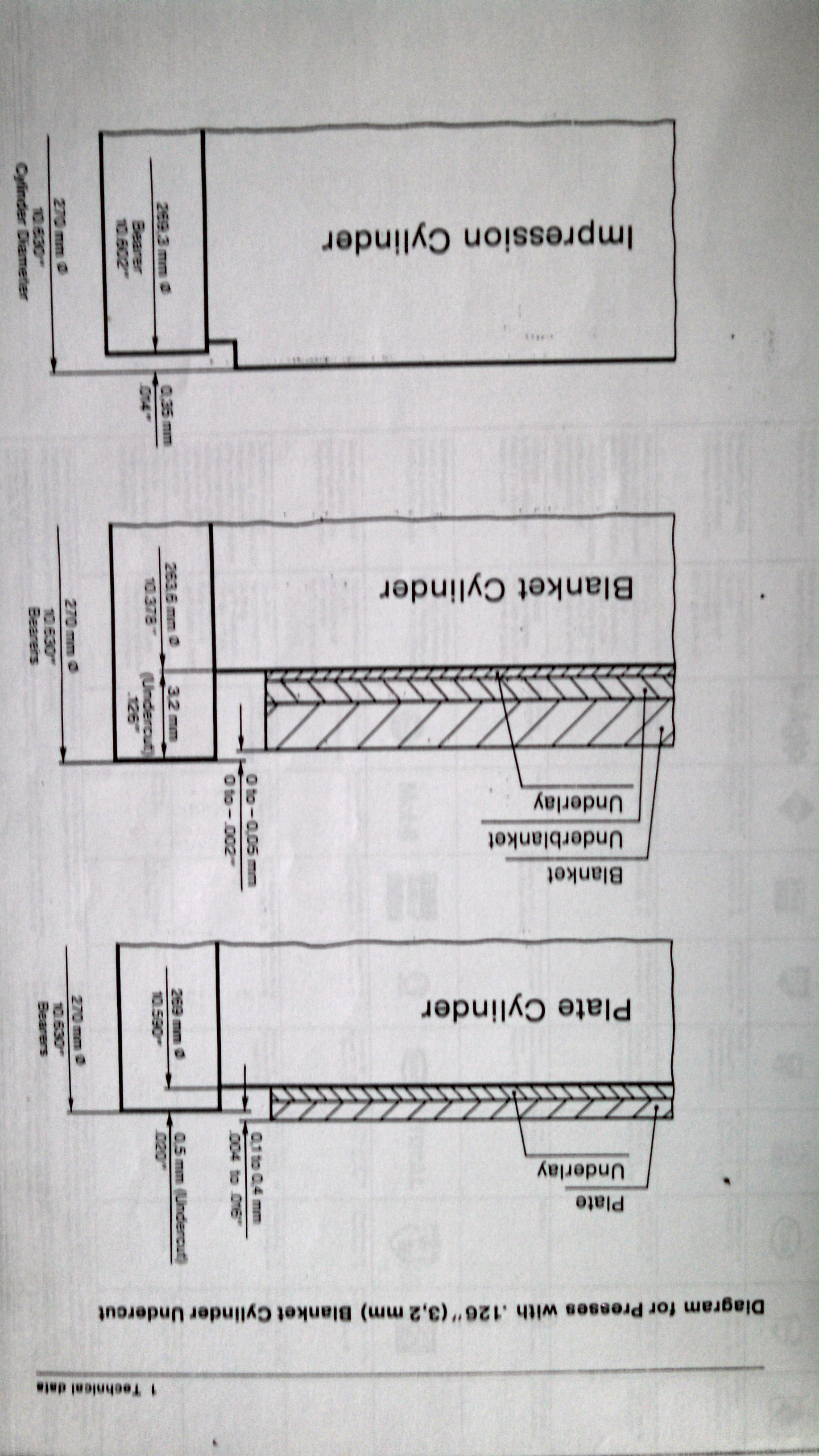

Hi i was wondering what is the proper settings of Heidlberg Speedmaster 52x72 -circa 1977/79- concerning plate/blanket.
Label on machine mention plate+packing 0,5mm and blanket+packing 3,2mm but since the machine has it's share of impressions how much over those specs can you go? When i tried to go a bit over -a lot i might add 3,5mm in blanket- packing tended to fold and move towards the grippers. I assume that happens because of overpressure or faulty install of packing?

Blanket should be below bearer about 0.05 mm and plates should be above bearer about 0.05-0.10 mm.

The extra packing was for plate not blanket, as for blanket packing creeping to grippers it was partly my fault since i had to bent them only 20mm and insert them under hooks -i did 50mm bent :S- and used 6 sheets instead of 4, by the way aqazi manual states plate 0,5 -0,30 plate + 0,20mm packing- but below bearer 0,05 and blanket the opposite -1,90 blanket+1,30 packing=3,20- over bearer 0,05
See the attached pictures of the manual. IMG_20150404_073113_789.jpgIMG_20150404_073024_142.jpg
