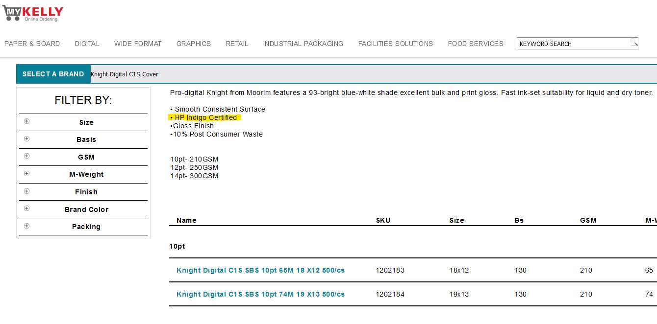

When we bought our Konica's, they provide a catalog of certifies stocks. I've heard Xerox does this, so I'm sure HP can provide the same thing if you talk to them. Additionally, we order our stock from Kelly-Spicers Paper. Their online catalog and printed catalog list next to each stock if it's HP Indigo Certified. See screen shot below. I'm sure if you check with you paper supplier, they can provide this info for you:
