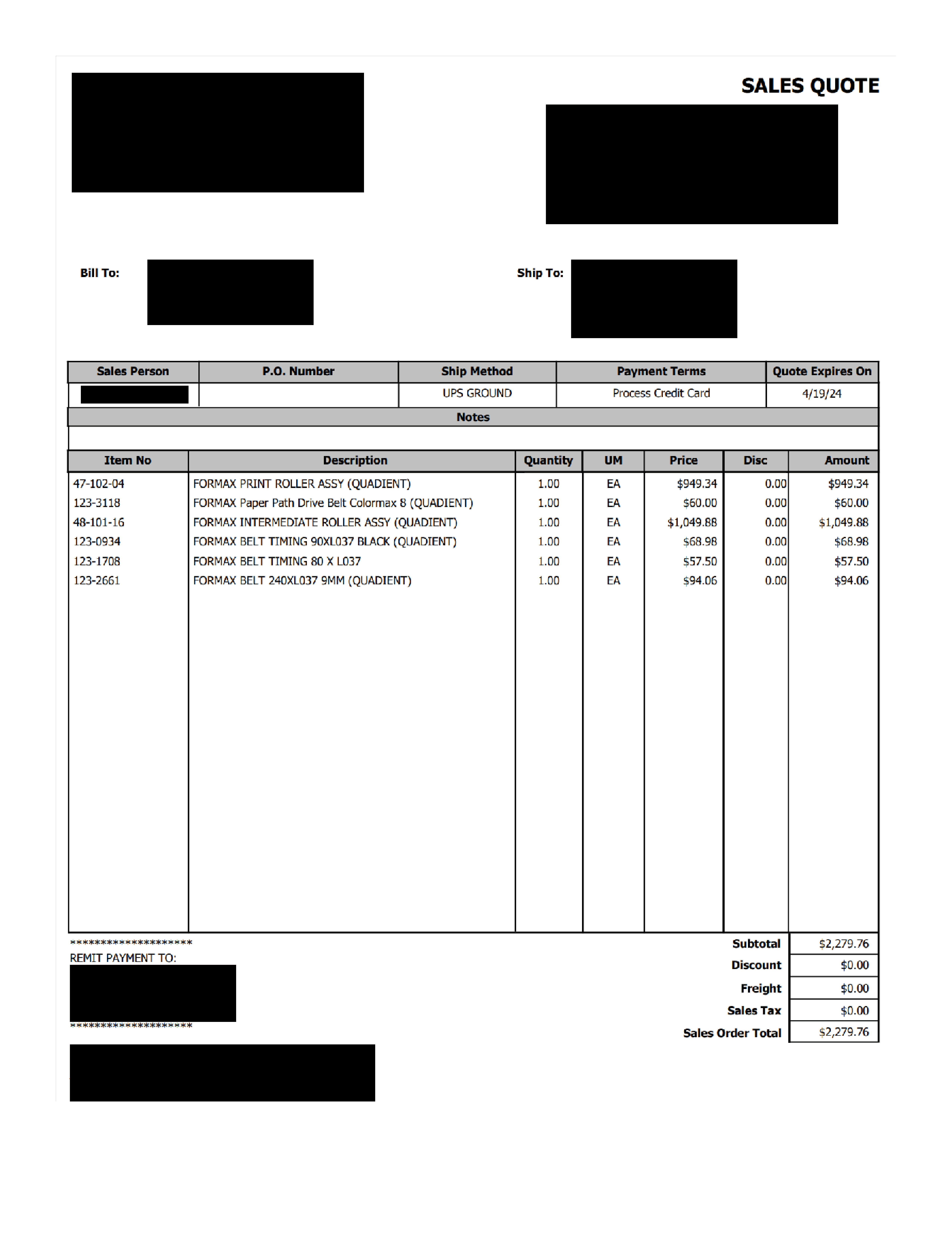

Anyone else who has a ColorMax8 or similar memjet rebranded printer - can you please take a look at this and let me know if this seems as crazy to you as it does to me?
I have a ColorMax8 that is just over a year old. Been a pretty solid machine for us, but it's starting to have some wear and issues that we couldn't resolve ourselves. So we called in the dealer we bought it from (no service contract). They looked at it and sent us a parts list for what they say it needs. First off, I don't think it needs all of this. Second, I think they're charging at least 2x what the OEM would be charging them. They want this PLUS labor. Please take a look and let me know your thoughts on this insanity, lol

We pushed back on this quote, because as previously discussed, the machine was relatively new and our utilization was nothing compared to others. I asked for their service manager to clarify line-by-line why each item on the invoice was necessary.
They came back and said that the technician that inspected the machine and gave us the quote was actually a PitneyBowes style mail-machine tech, not an inkjet tech. As such, he didn't know what he was doing or how to address the problems we were having, and just reccomended replacing every single consumable. They sent a different tech out who told us our machine was fine and needed no parts. We've asked them to clarify why this happned and to give us a maintenance/service agreement so if expensive repairs are needed in the future, we're not surprised like this.
