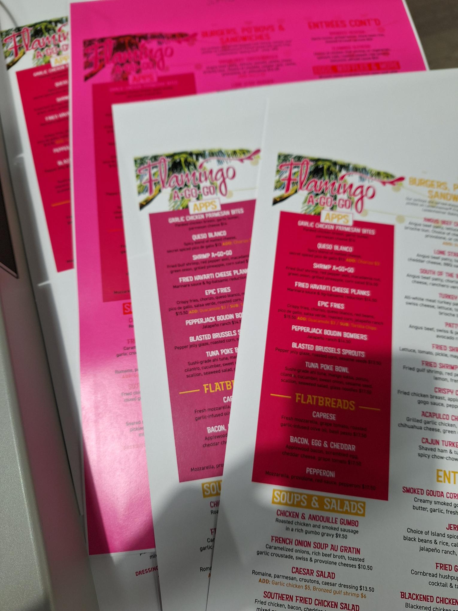

Can anyone give me detailed instructions on how to use this feature?
My file has the spot color created and applied to all text and rectangle boxes.
When I open it in Fiery, go to SPECIALTY COLOR, there are some options I can click and unclick.
I've tried them all and cannot get my desired results.
I'm trying to get neon pink onto some text and reverse boxes. I can see the color has changed in these areas, but they are not neon pink.
If I click FULL PAGE, that's when I get the neon pink, but it's the entire page, literally.
I've also tried converting the text to outline but I'm still struggling to get my results.
seams like your neon pink is magenta
is that what neon pink looks like on the ricoh and not like the barbie pink?

What did you call the layer in the file? Were you using InDesign or a different software. I have two Ricoh 7210 with 5th color. I have one as clear and one was white. I have one file that we use for clear and when I tried running it on the white 5th color printer, nothing happened. When I changed the layer name to white using InDesign it did work. I did not think it would matter but something to look into. I saw a Youtube video and they called the layer or swatch NeonP. Maybe that will help.
by "layer" do you mean the design layer or the color layer?
Here is the YouTube video I found. I think you need to create a swatch and then use that as the layer color. Hope the video will help.
I just watched this one! LOL! Still not working tho. my Fiery has a COLOR and a SPECIALTY COLOR tab on the left. When i go to SPECIALTY COLOR, i have all these options I can check or uncheck. Playing around with that now.
I'm not sure what the spot color needs to be named for the Neon Pink, as we only use Clear and White. For us the spot colors need to be named exactly Clear or White and the capitalization matters.

As a Ricoh customer you have access to the site called Ricoh Business Booster where you can download all the how-to guides, tutorials, sample files etc. Contact your sales rep or solutions engineer (the Fiery guy) for help logging in if necessary. If you're not getting the response you need drop me a message.
Make sure it's a "spot" color. (not just a color) .You can add other color names on the Fiery too. under the file menu - Server: Device center: Specialty colors: +New.
I added NeonP, neonP, pink, Pink. to cover all bases.

another trick i have learned is that all the other colors in your design have to be CMYK. you can only have 1 spot color, regardless of what you name it.
YOU ARE THE WINNER!!!!! I have been stressing out over this for a week now! Man, you made my Friday! DRINKS ON ME!!!!
