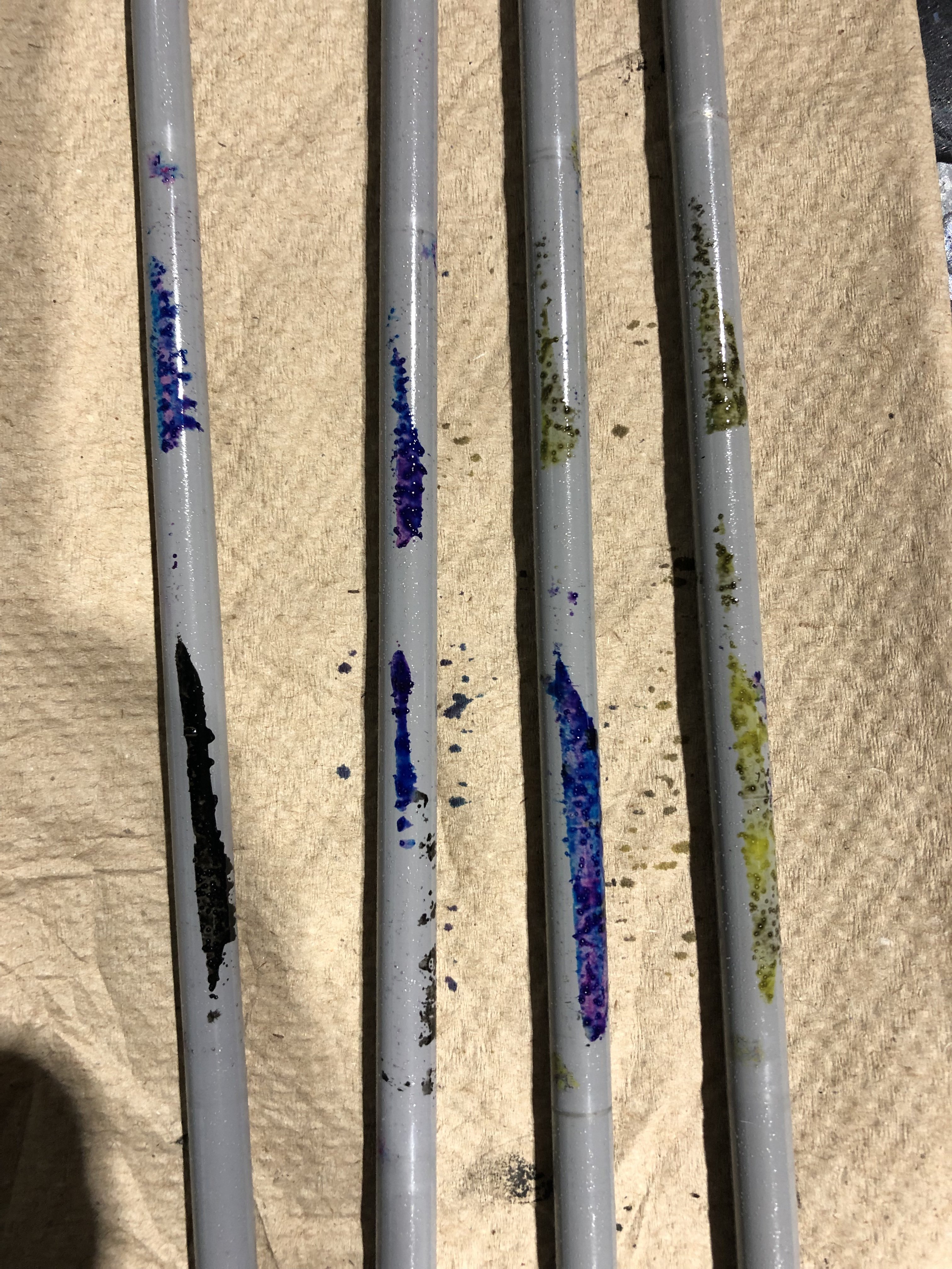

These machines also use diamond coated KB rollers to keep stock running under the printheads. These rollers wear incredibly fast and that diamond coating comes off and it grooves down to metal. This causes horrible head striking with both paper and envelopes.
Head striking will absolutely destroy the inner printheads, by causing them to be scratched and grooved very easily. A single envelope jam can cause us to need a $3000 printhead. That’s what each printhead costs for us and there are 20. We have replaced a printhead and destroyed the new one the next day with a jam. You are also going to be cleaning ink off those rollers consistently. If you have any kind of tail strike, splatter or head strike, it’s going to dump ink all over those rollers and then roll it onto every other piece of stock, unless they’re cleaned. They have to be meticulously removed by crouching on the floor, taken to a sink to be rinsed and then let air dry. They are diamond coated and you can’t rub or wipe them with a cloth or youll wear that coating faster. I typically had to do this process 5-8 times in an 8 hour shift, and sometimes a lot more.

Pictures below are the KB rollers that need cleaned frequently after being saturated with ink.
Our model specifically was the Riso ComColor GD9630.
