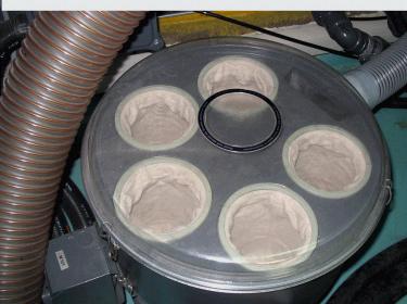

attached is a photo of the pump for the sheet cleaner that's on my 700. The brush is in too far to get a picture of.
and you're welcome............

Thanks loopg66
could you tell me how well it works , ie how effective is it at keeping the blankets ,grippers etc does it help to keep a lot of debris out of the damp system. regards john
