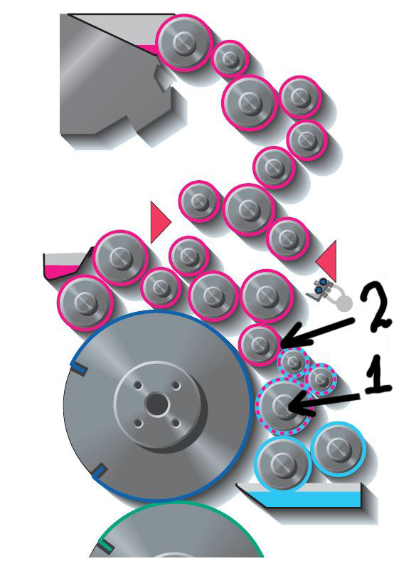

Got a question about damping system: press operator got option called somewhat "inner delta"

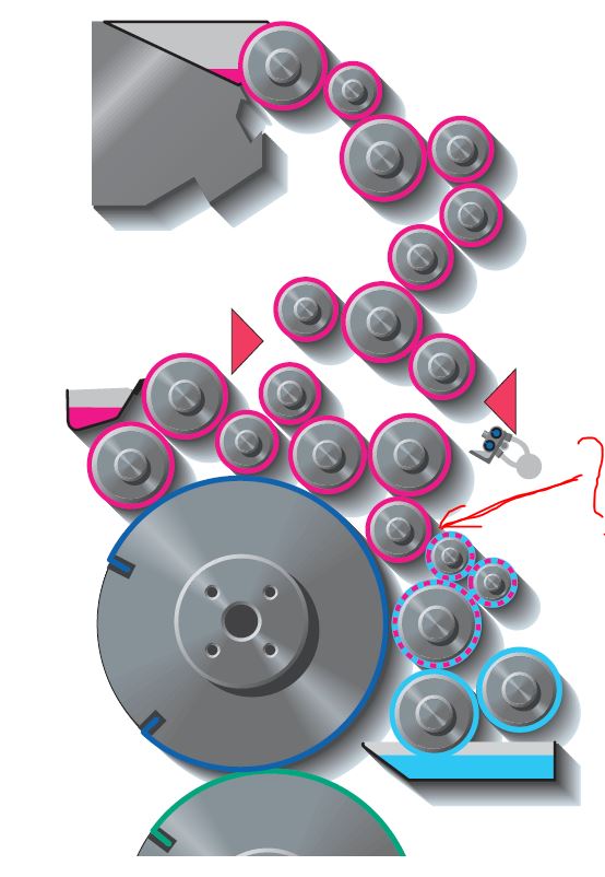

If this option is on it makes a connection between ink rollers and damp rollers (see picture)
would there be difference in dot gain with this option on or off?

I would agree with this, but pressman told me (actually he shown) that when "inner delta" option is on he had to increase % of water in ink/water balance to prevent scumming. Plus water form roller rotates faster than plate cylinder with delta (outer) on

Just to make things clear:
1 - is "Delta effect" itself with different speed of roller
2 - is what called "integrated"

You pointed out right in the pic, 1 is delta effect and 2 is integrated.
