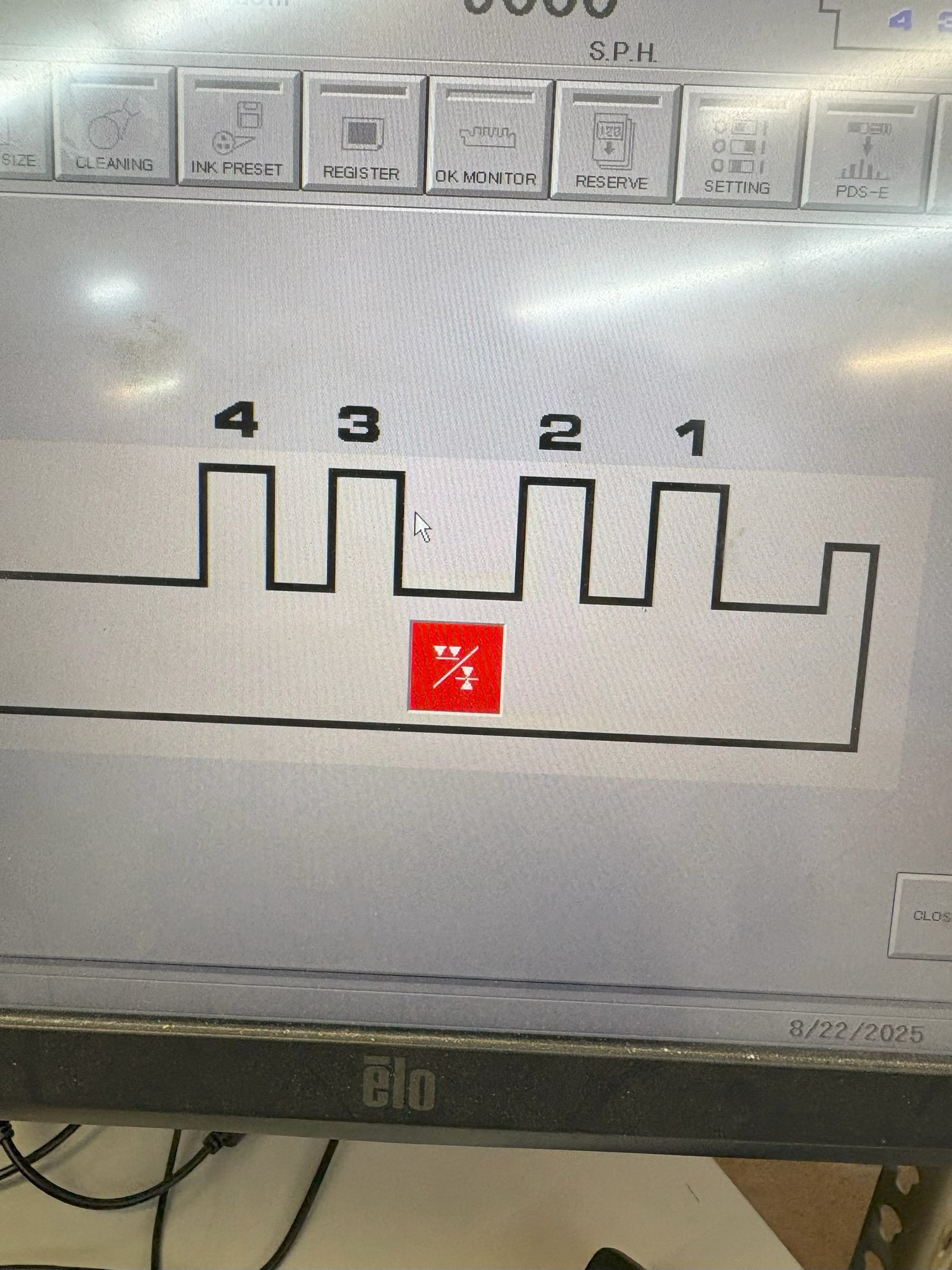

Getting this error on startup. It can be cleared and run for straight 4/0. Concerned that if we switch into perfecting mode there will be a problem. Not much guidance in the book, sensors appear to be clean and functioning.
Anyone ran into this before and offer insight
Hi Sir:
Usin the press for a long time , without changing the status printing system from : sttraight to perfector system: CAUSE insuffiency of lubrication oil at each part of the press !!!!
Therefore the status of printing , must be switched periodically ...!!!!!
The press display a message for to remember the operator . !!
