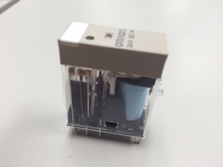

I have been watching the vacuum switch and the blower for a couple of days and it seems I have a sketchy relay and or vacuum switch. Ordered both and will know more next week.
No Title
Try replacing the relay in the blower. Its fairly inexpensive.
