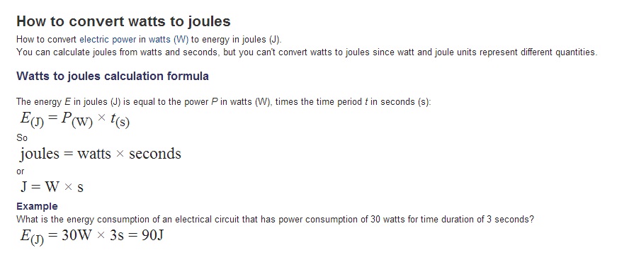

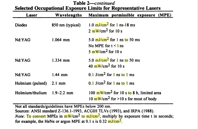

Enclosed please find the attached files for the conversion.
To give you a rough idea, mostly plates between 120mj/cm2 to 150mj/cm2 can be used on screen machines. Please consult the plate manufacturer for this. Regardless, what the manufacturer claims, you will be the one who decides the best plates suitable for your machine. This is best determined and addressed by conducting tests and obtaining the best dot gains and density on the plates. Regardless, every batch of plates might be different from the others so the calibration of laser is a must and has to be carried out to obtain the optimum image quality and the highlight and shadow dots.
Hope this will help!
