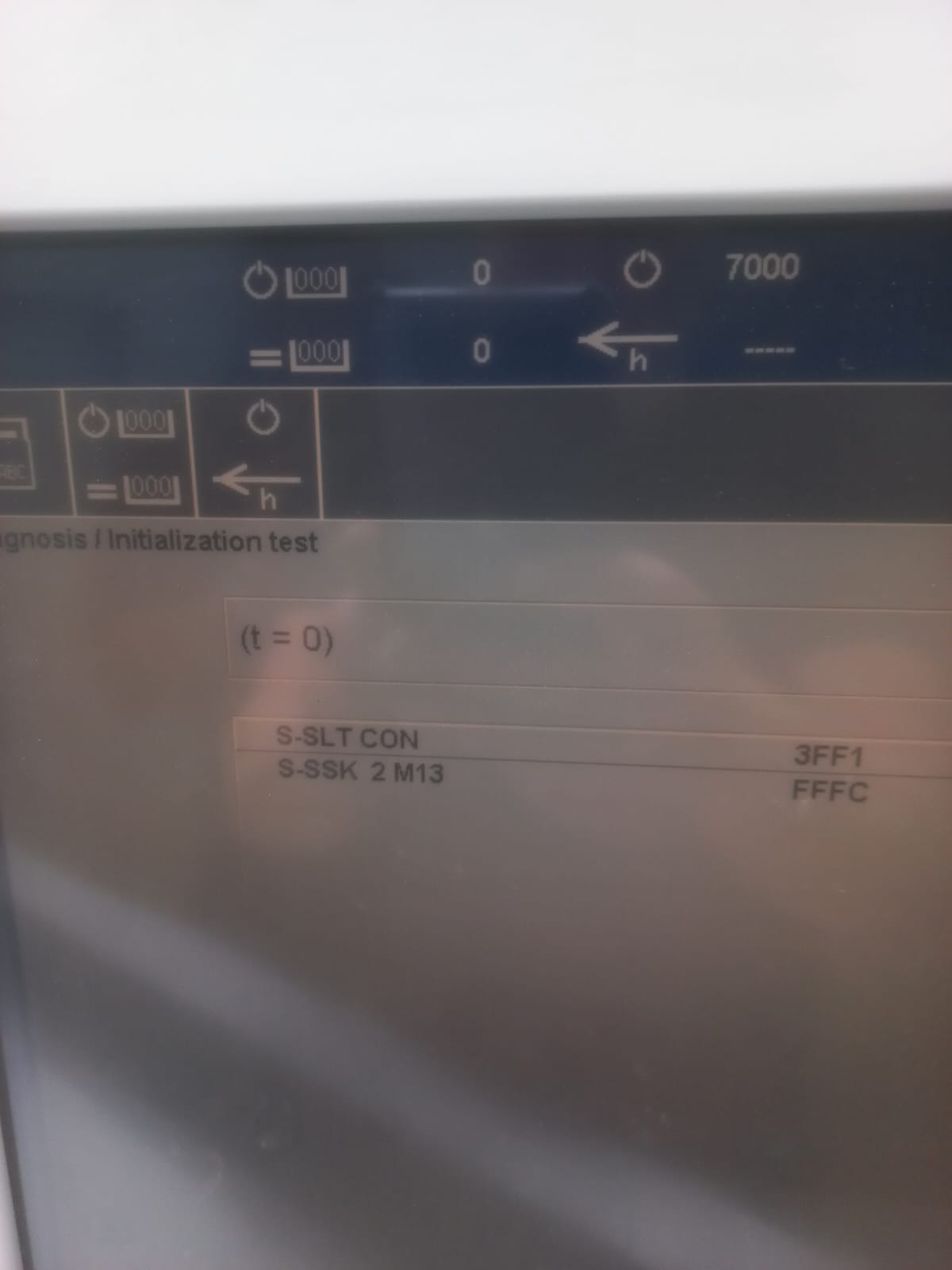

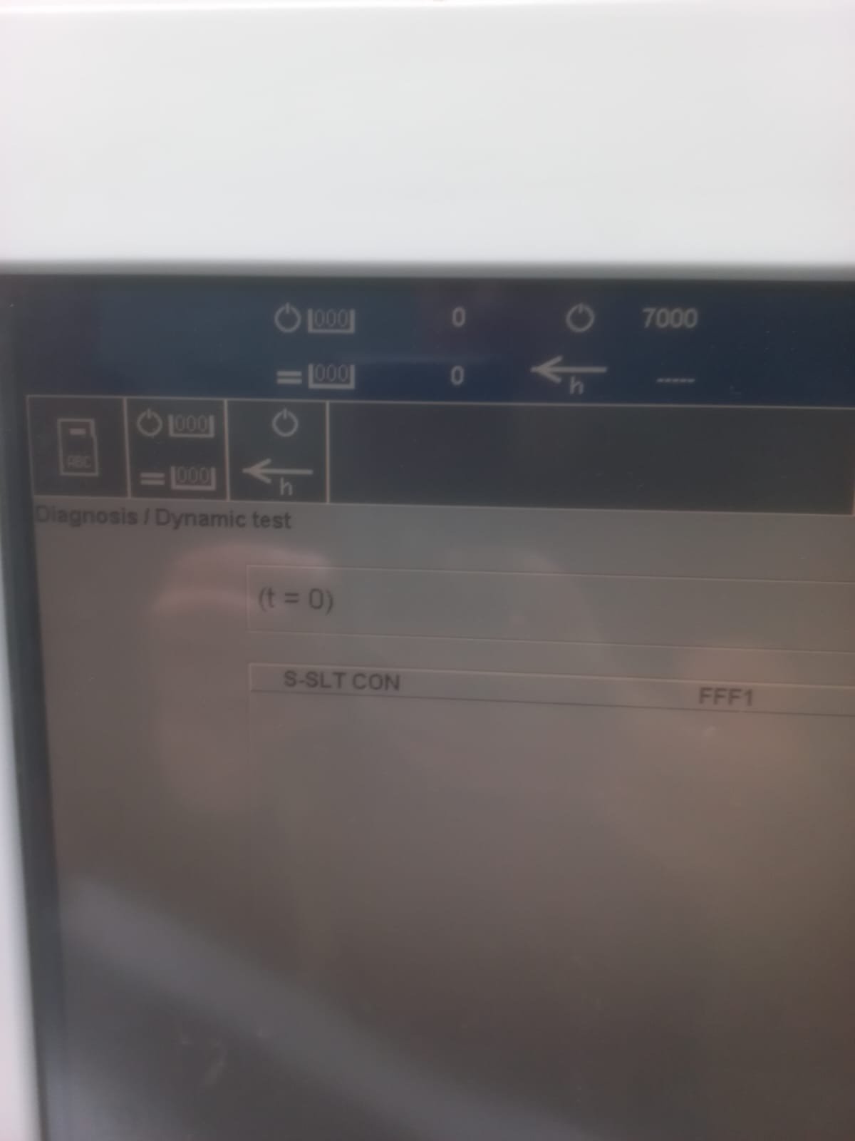

After this happened, we had the following errors:
DYN TEST: S-SLT CON FFF1
INIT TEST: S-SLT CON 3FF1
Based on an older post on the Color Printing Forum, we replaced the VOLTAGE DETECTION MODULE (located on the SLT Board) and these TWO errors were resolved.

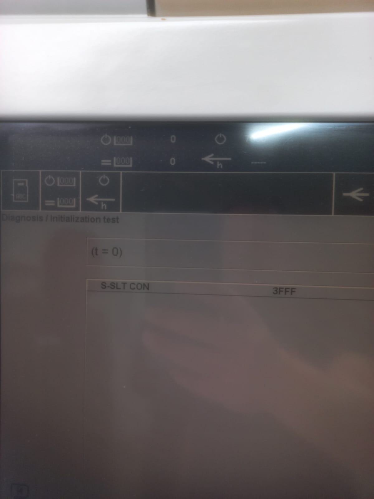

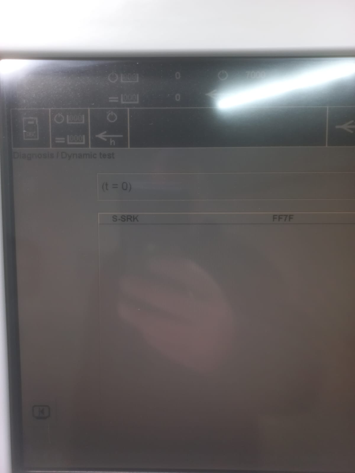

Today - when trying to inch the press, we got the following TWO errors on the CP 2000 console:
S-SRK FF7F
- sometimes it changes to FF6F - when this error came up, we could inch the press slightly but the movement was erratic and the motor tends to rock backwards slightly when it stops)
S-SLT CON 3FFF - this error is intermittent - when this error appears, no movement is possible when trying to inch the press.
Could anyone please advise on what might be causing these errors and what the possible solution could be?
How do we test voltages going to the MAIN MOTOR please?
Is there always voltage below the SLT (4 black wires) - can we test voltage here when the press / motor is not turning over?
What voltages should be present at these terminals / wires?
Please can anyone assist? We cannot move forward with commissioning the press due to these 2 errors that have appeared today.
