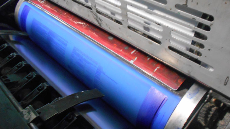

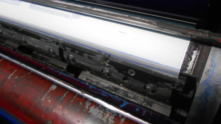

The scum line is caused by form rollers not being set properly, the form to oscillator pressure must be greater than the form to plate. The form rollers are a slave they can be driven by the oscillators or by the plate if they are driven by the plate you will get the scum line.

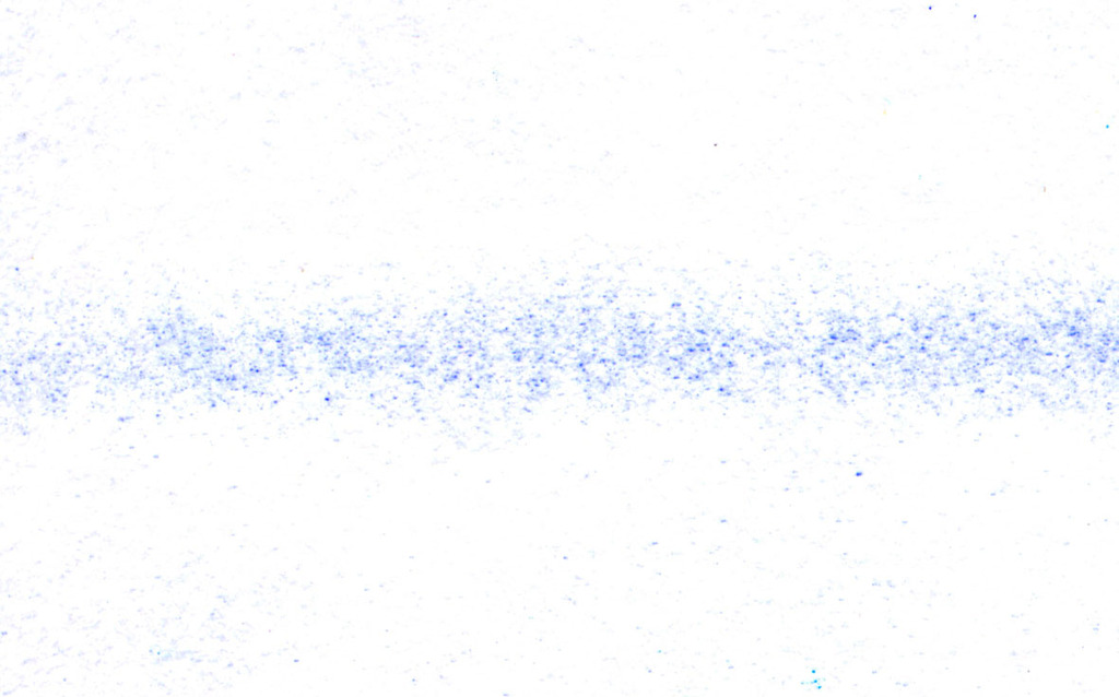

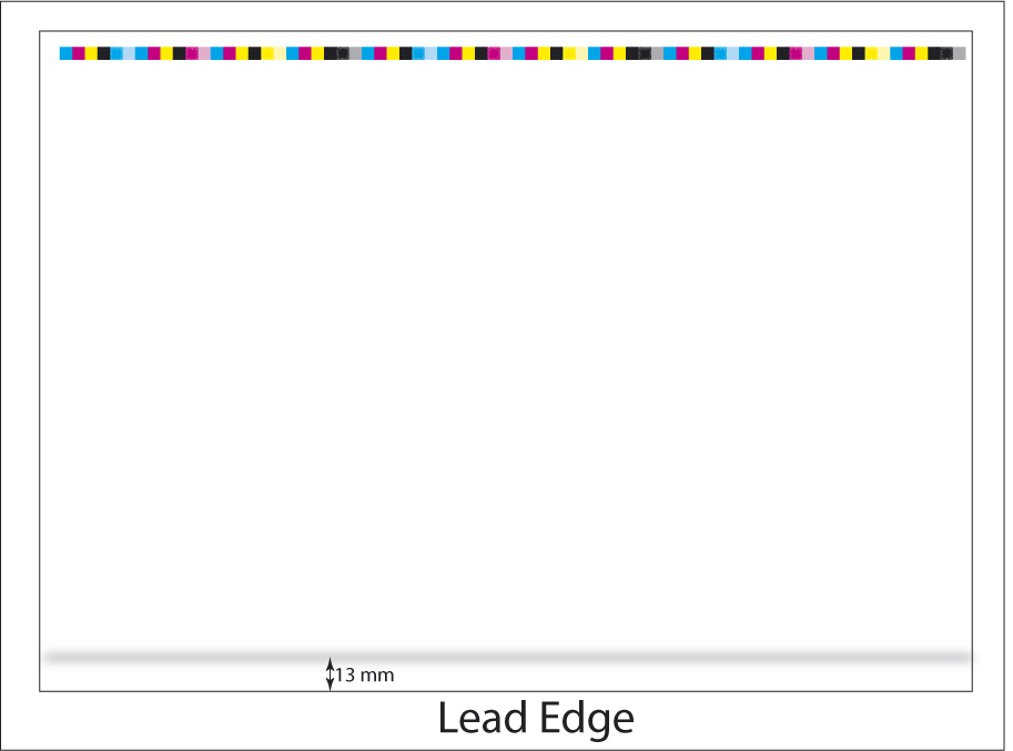

I made a mistake in the thread title.
Blurry strip on lead edge of PAPER (not Plate).
Scum line on plate -> 1 mm or less (see photo).
Its normal (normal?)

Try lightening the form roller to plate pressure especially on the last form and see if the scum line goes away.
