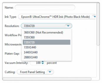

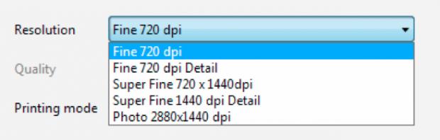

I know that Kodak Proofing Software can use various symmetrical and asymmetrical resolutions (360, 720, 1440x720, 1440x1440 etc) and CGS ORIS Color Tuner Web has similar options.
Stephen Marsh
Stephen, so you are saying that 1440x1440 data can be sent by Kodak and others to the printer without it being downsampled to the native resolution (720) first? That is what I am hoping to find possible.
I believe that this is so, when 1-bit proofing of high resolution separated plate files is used with KPS, one must use a 1440x1440 resolution media configuration (in KPS the media configuration controls most of the low level features of the printer).
KPS:

CGS ORIS Color Tuner Web:
CGS-ORIS.png - Click image for larger version  Name:	CGS-ORIS.png Views:	1 Size:	16.2 KB ID:	263506
Stephen Marsh
