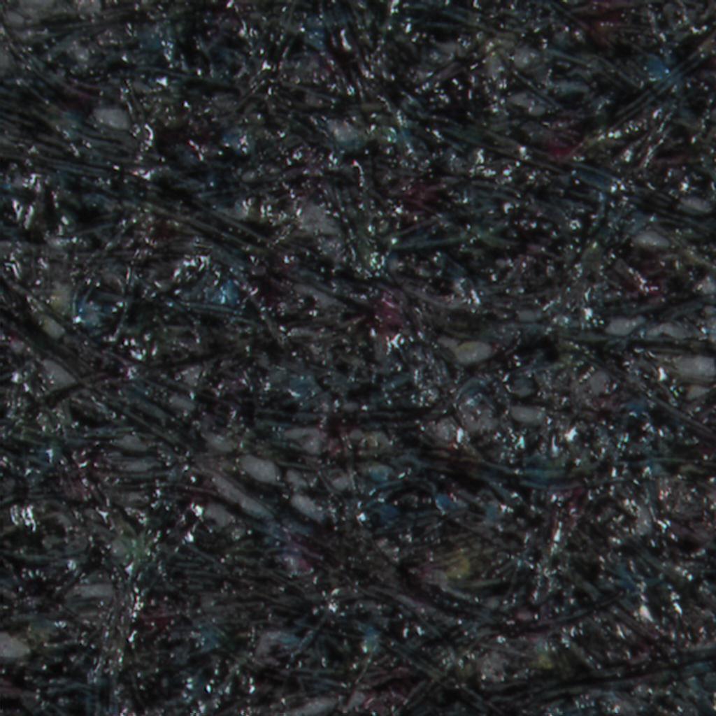

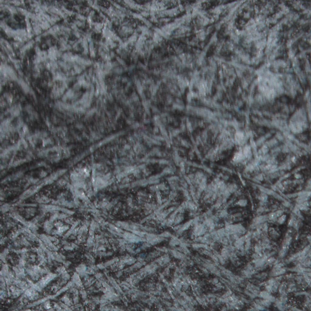

Attached is a picture before rubbing the sheet and after rubbing it. Dry sheet.jpg Dry sheet rub.jpg

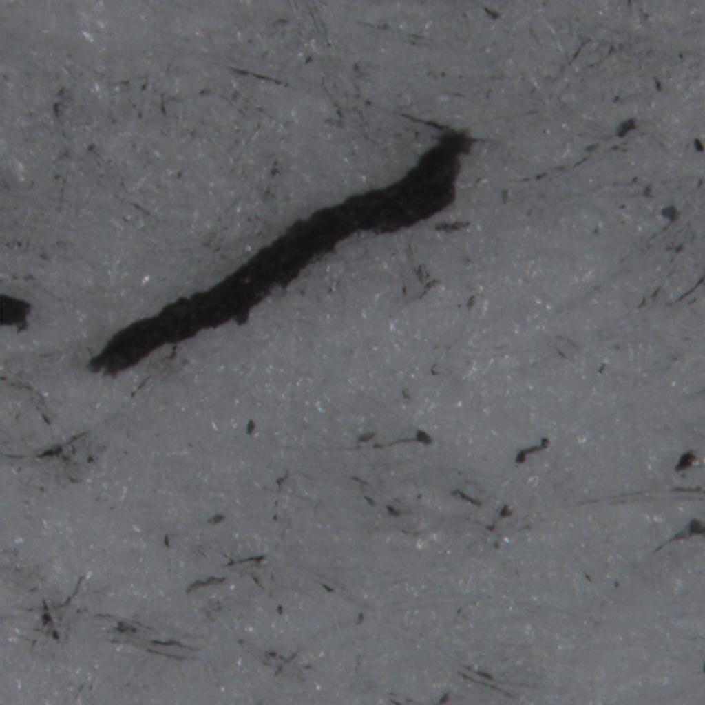

Now a picture of what the rubbed off "ink" looks like compared to blank white background.
