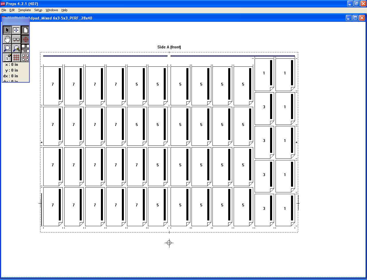

Perhaps I have mystified everyone... Because I don't have access to the Signa Station interface, here is a screen cap I found on google (below) ... pretend its a 'montage' imposition ... how can I change the folio assignments without having to rebuild the impo? I would, in essence, simply like to click on the page(s) and change its number, that's all. Is this possible?

I guess what I mean is ... please see the Preps screen cap below, let's say I want to change page 1 to be 8up, not 6up. And then in turn, make page 3 only 2up, not 4up, because quantities have changed. In Preps I would simply click on each page and change its assignment, 2x of the page 3's change to page 1, leaving the result 8up/pg1, and 2up/pg3. This was quiet simple and fast in Preps ... however in Signa Station you have to deconstruct to whole right side of the form and rebuild brand new page groups.
I hope this is clearer, thanks again.
