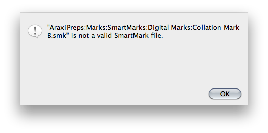

sometimes it still is necessary to build some templates using 5.3 … now, when applying smartmarks … error-message appears (for each offending mark) … "araxipreps:marks:smartmarks:ETC.smk" is not a valid smartmark file". if there are 28 invalid smartmarks … am met with 28 error-messages.
Smartmarks changed from 5 to 6 I think. If you ran the migration utility when you upgraded to 7 it would have converted the old smartmarks to the new ones. If you are now creating templates in 5 and trying to use them in 7.1 the smartmarks won't be compatible...as you've noticed. Why are you still creating templates in 5?

Sorry for the confusion and yes, smartmarks in 7 are not compatible with 5. I doubt if there is a work around for this.

So to your error message, I get that when adding smart marks in Preps 5 but only for one mark (not 28), however I have saved many smart marks with Preps 7, just a long shot but because in Preps 7 you can access individual marks from inside Groups (Folders) my Preps 7 generated Smart Marks are organised into Folders e.g. Colour Bars, Text Marks, Perfector, Ganging..., I'm wondering if because Preps 5 can only see these Folders as Groups if that is reducing my error message count?
It may also be possible to point one of the Preps to a different default Marks folder on the server, but not sure if this would mess with Prinergy signature selection?
hey, glenn … i revisited your suggx for alternative marks location (preferences) … with my circumstances, this seems to be a viable option. created parent-folder "preps53" within the araxipreps directory … only two child-folders (marks, templates) reside within the parent-folder … and, in this case, removed those 30+ offending marks. prinergy seemed to respect this provenance during media output … all is well.
