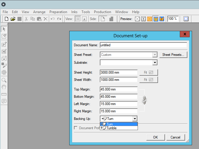

If I understand correctly, the back orientation of the turnover is set during document creation.
