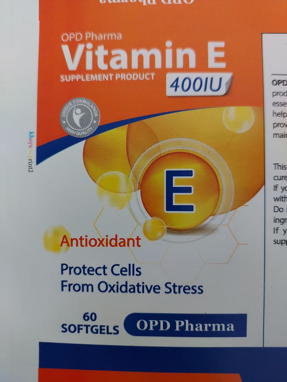

I am uploading the pdf file here along with the printed sample, I hope it will help
Please see hexagonal pattern
