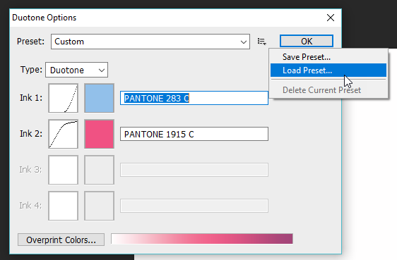

I will be very interested in learning how one can reliably measure spot color tints. Color me SKEPTICAL as we all know draw downs / ink opacity and paper white will all F&%$ with any attempts to "share" what I get with you so you can do what i did. - When I worked at Pantone, we developed / manufactured a Pantone Duotone Swatch book - we even included a cute CD that had loadable Duotone presets that would *ahem* allow you to apply them to your images in Photoshop - yeah.
Right. Like paying darts in a tornado.

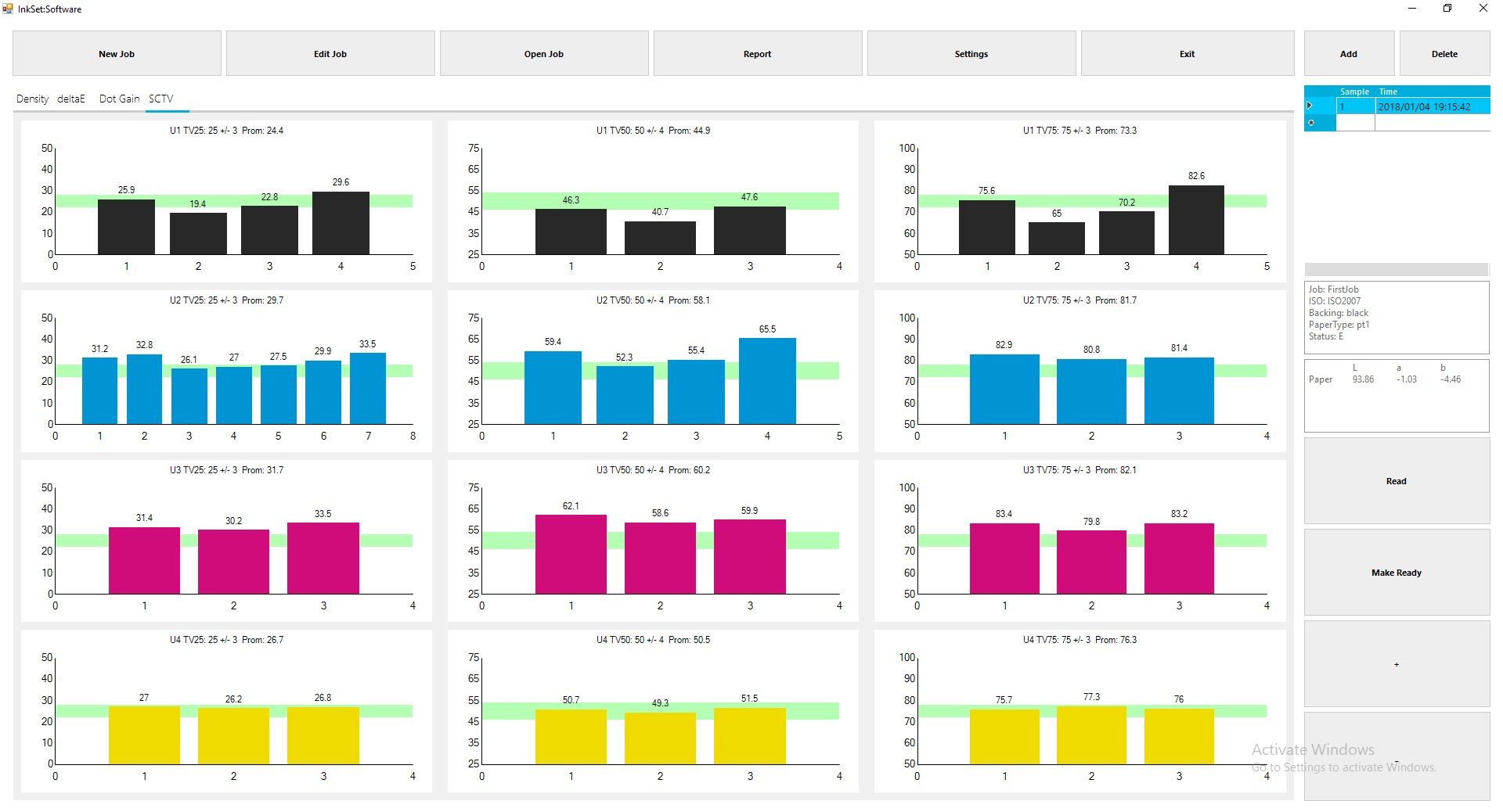

The spot color measurement metric that Techkon has added to their spectro is one that has been officially defined in a brand new standard, ISO 20654. The standard is based on work done by the SCHMOO group. (I am proud to say that I gave the group its name: Spot Color Halftone Measurement Optimization Organization.)
The approach is a different formula than the Murray-Davies formula that we all know and love. It has been found that for many spot colors (particularly those that are either very rich or are pastel) that the Murray-Davies formula does a lousy job at measuring anything useful. The committee compared about ten other possible formulas, and the SCTV (Spot Color Tone Value) formula won in the press tests. The new formula gives tone curves that look much more even, and which does not require extreme plate curves.

Here you could find more information about the ISO 20654:2017 related to SCTV
Regards
