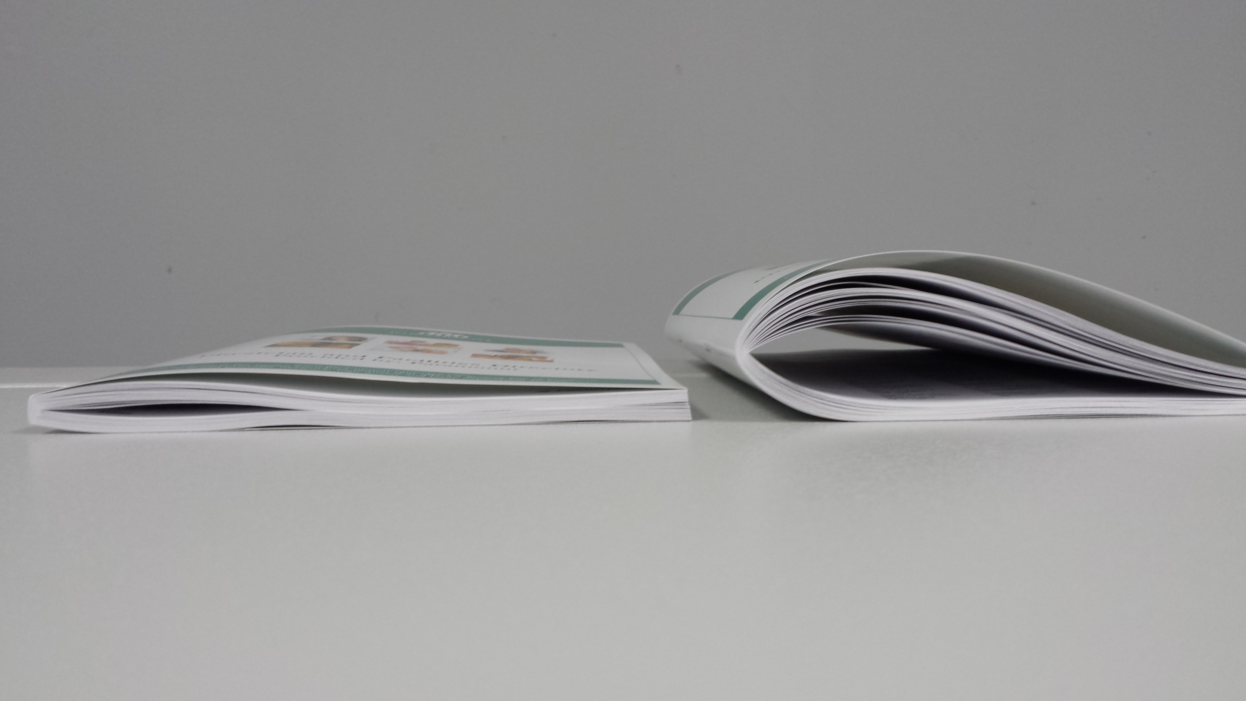

We usually do if they are cover weight and have toner on the fold. It folds first like normal than the square fold is the last step. So if it is going to crack without the square fold it will still crack with it.
To be clear, if you run a single crease for the fold, and cracking is not evident, then you can run this booklet into the square folder and it will produce no cracking, even though it is not folding on the crease?
I've only ever done a single crease. It's not working quite like you think. It's not folding it in 2 spots. It is the last step of the process. It gets made just like normal first. Single fold on the crease. The square folder doesn't actually fold anything. It just clamps the book and applies pressure against the spine of an already finished book that will flatten it out.

No. The process is stitch, fold, face trim, then square fold. So we face trim before square folding but it can be done after. The square fold doesn't have any effect on the trim. It's really just an extra step that gets done to finished booklets that flattens the spine.

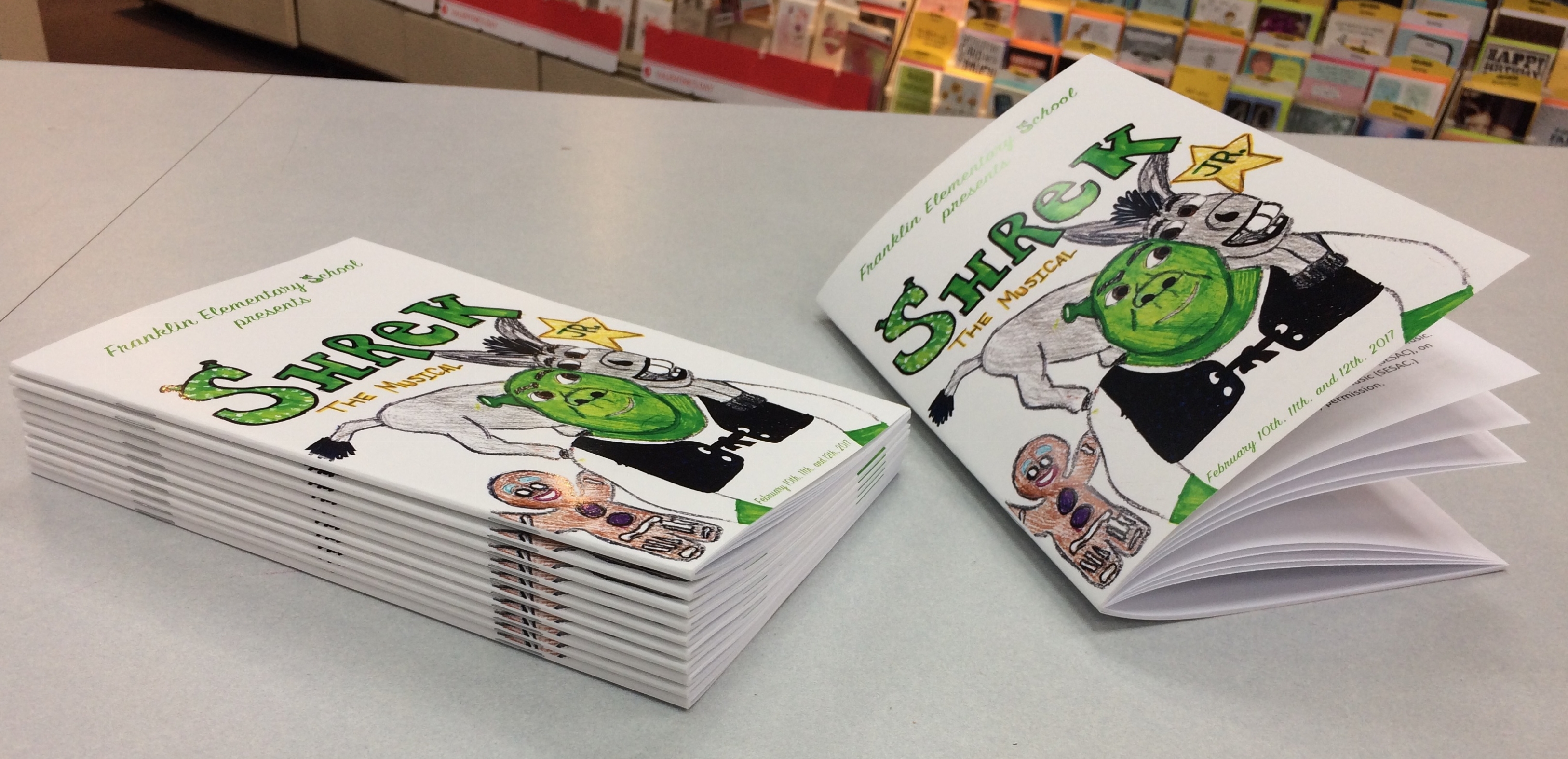

Ok, I bit the bullet and got one.
I used the contact form on the Formax website and had a rep contact me the same day. Not only that, Erik actually drove 5 hours each way to bring me out a machine to demo. I kept it.
Here's a photo I took. My C700 has a saddle-press which helps a little but I really don't need to use it now.
I was able to fit 400 36 page booklets (80# cover, 24# inside) in one empty Husky box. The box was way too heavy to move so I ended up repacking -- but boy do they stack! Absolutely no problem in the guillotine -- no more booklet clamps for me......
