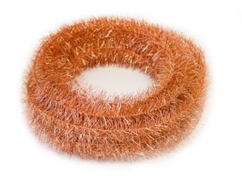

try draping some of this Tinsel on the feed section to ground out static. Install deionized air for sheet separation in feeders. Keep Humidity of paper area storage.
