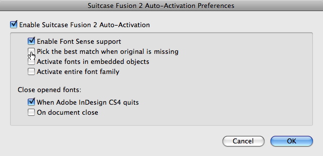

The problems that you're having seem to be because you may not have the correct settings implemented in the auto-activation plug-in.
There is a setting that controls whether the plug-in picks the best match if the user does not have the font installed. If you disable this setting, then it will be immediately apparent that the font is not available (in the case of your symbol font.)
If you enable Font Sense, then you can be sure that the correct font is always active, since it doesn't activate the font based just on the PostScript name, but by precise identification of a variety of metrics. Suitcase Fusion is able to read Font Sense information that was saved using Font Reserve, so you'll always use the right fonts, even in older documents.

If you have the following conditions met then the correct font should always be activated:
1. Auto-activation enabled.
2. Font Sense turned on
3. All of the appropriate fonts necessary for the document must be in the Suitcase Fusion database.
If you don't want to have font substitutions made, be sure to turn off the plug-in preference to do that.
If you're still having issues, I would definitely recommend contacting support. There may be font corruption or other issues that are affecting your workflow.
