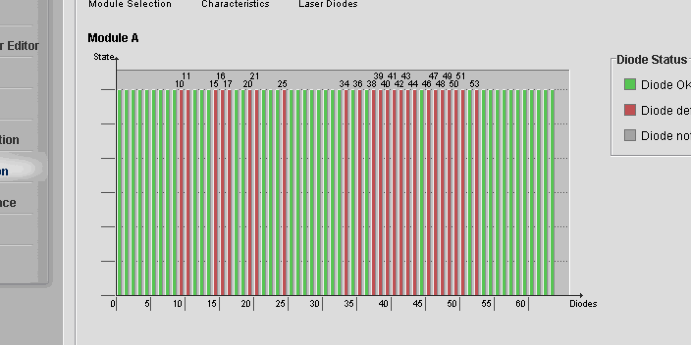

good day! can somebody help me with the laser problem of suprasetter a106 coz theres 8 laser diode are faulty and now the machine is working but its to slow it takes 10 mins. per plate. some screen are missing to.. thanks

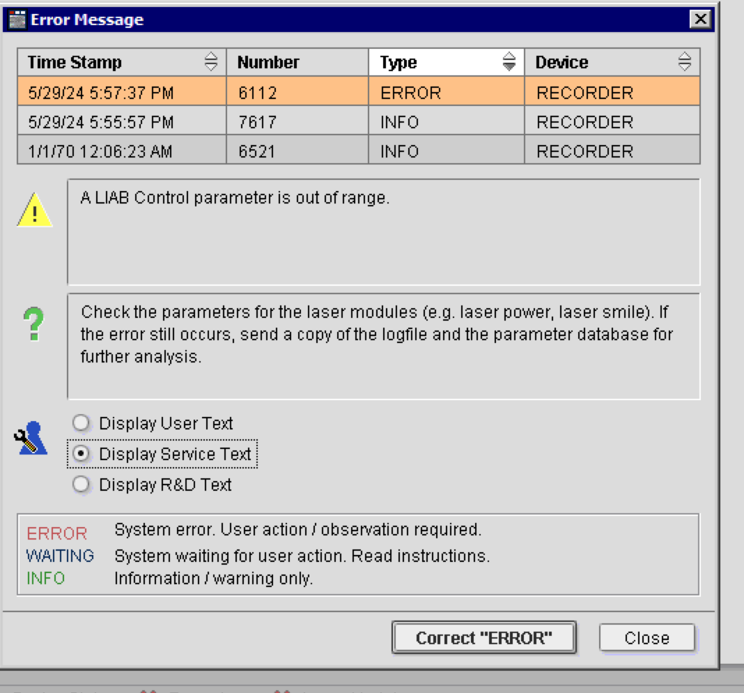

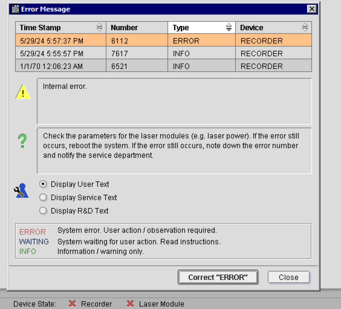

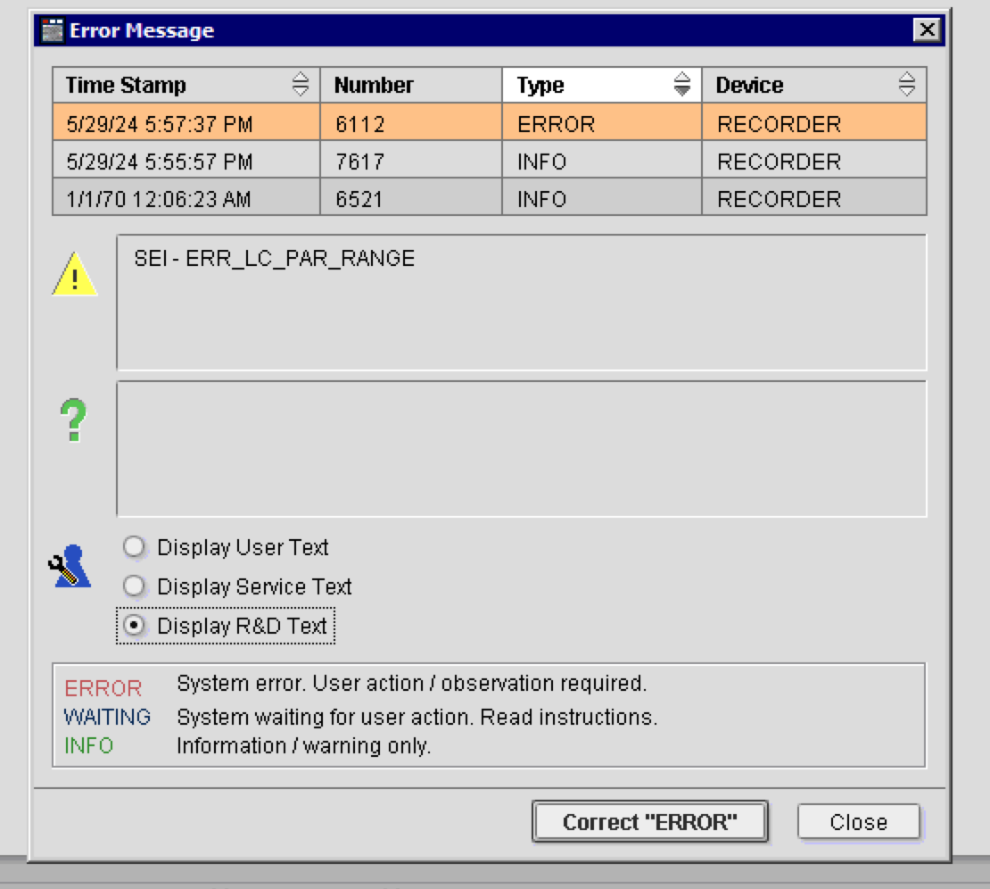

Suprasetter A52/74 CTP has a laser problem. I share screenshoot with you. Actually, this laser was running, it went into fault mode and almost half of the Laser group was red. Then it worked again in emergency mode , starting at number 54 but with slow exposure mode.
When he updated the program ,GUI, It never worked. I installed another laser head with number 2 and 3, fault but it didn't work either. Error Number 6150.
Although I set the starting Diode number 54, it gives same error .. I miss something in sight?
