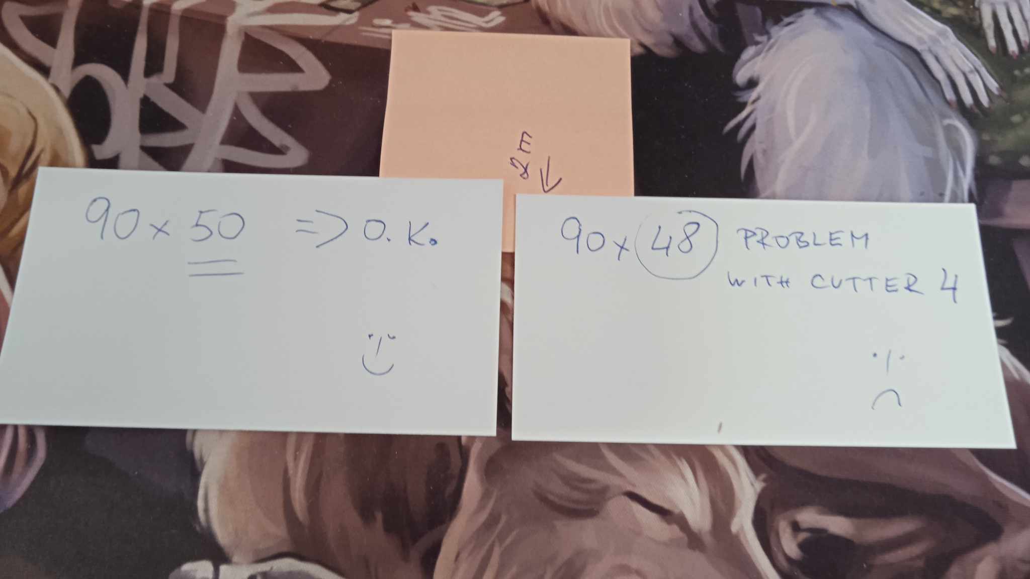

Please, I have a problem with knife No. 4. Trims 2mm less than others. The work is set up for the correct one. It is supposed to cut 9x5, but for knife No. 4 it trims 9x4.8.
Not sure I am following you. I have a 645 and it only has one knife. It does have 6 slitters. Is that what you are talking about. I have not had to manually go in and adjust any of the slitters sensor breaks but I have done that in the perforator module. The metal piece that breaks the sensor path can be adjusted so that it homes correctly. Of course you could always just you measure to account for that 2mm if you can figure out which one will be using #4.
Please how and where do I enter the service menu for calibration?
There it should be possible to adjust the width of the cut paper.
Can you cheat and fudge the numbers? You technically have to take something from one of the sides of the cards and add it to the card whether it's the gutter side or the end. I'm not sure what's in the service mode
I just took a look at the slitters. It appears that it is possible to adjust the metal plate that interrupts the homing sensor signal.

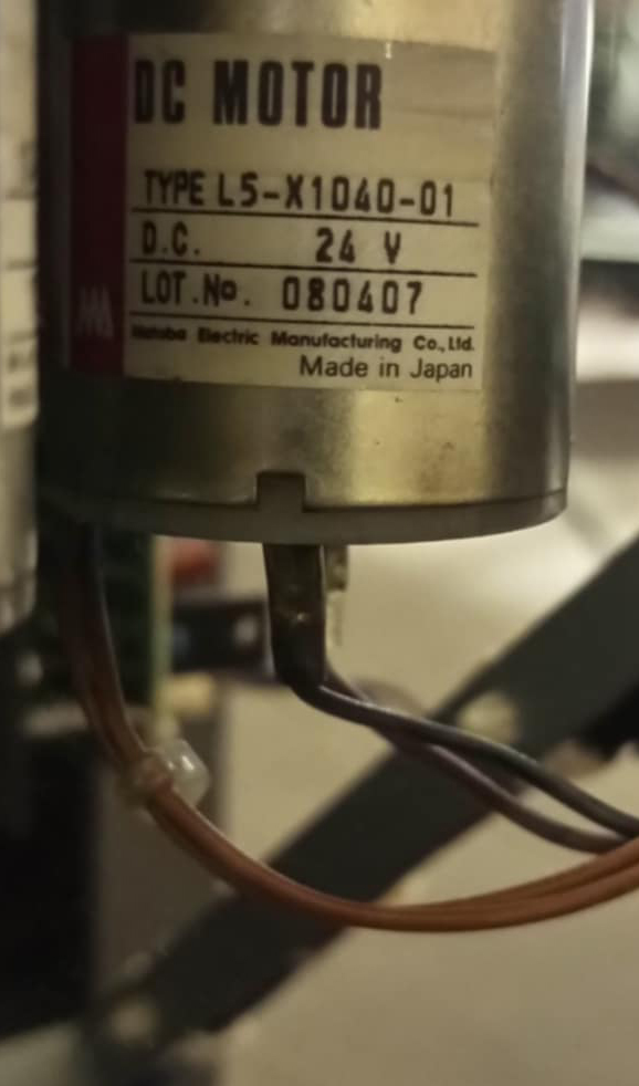

Are you sure it's the motor? Never replaced one before. Most of those motors have gear reduction boxes attached to them. Maybe its in the gear box.
Yes, unfortunately yes. A new one is already ordered (quite expensive :( ). What bothers me a lot is that it's impossible to find out what its RPM and Watts are anywhere, it would be much cheaper then.
I've run into this on another piece of equipment with the same result. Sometimes motors are custom made for OEM's. That's why you don't see anything on the web related to the part # on the label.
