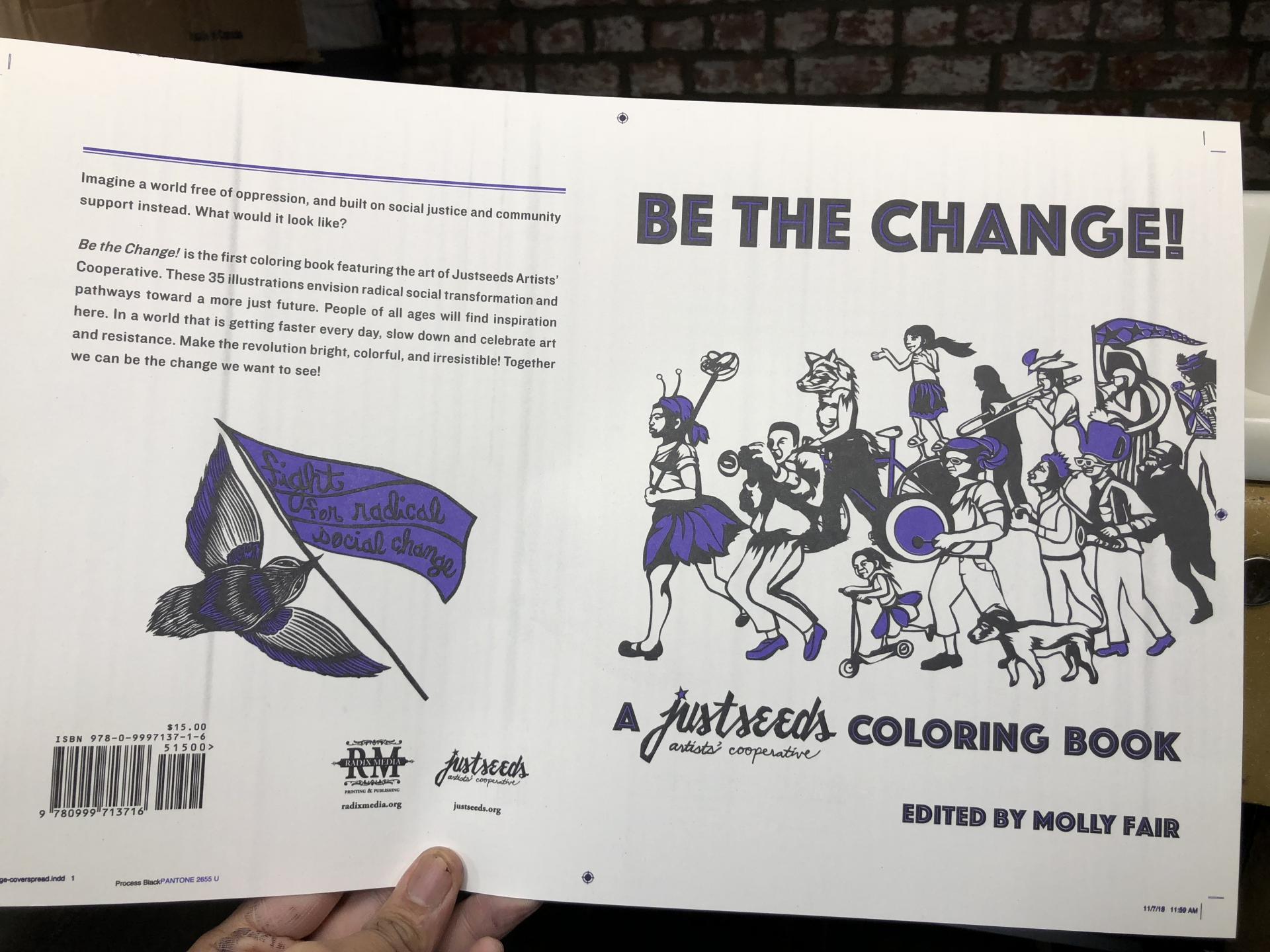

Hey everyone,
I'm having horrible tinting issues and it's giving me such a headache! I run an Itek 3985 with Crestlines. I use Universal Pink fountain solution and have taken to using a fountain additive called "Stopz-It" which is kind of a dumb name but does wonders to eliminate toning. The press is not in a temperature-controlled space so I've found that this helps to run less water and come out okay. The past couple of jobs I ran were small envelopes, and previously before that (in the Spring) I ran a 150 page book. I'm printing a booklet right now and BOTH heads have the same problem. At first I thought that the Crestline just wasn't inked up enough and if I dump ink into it, the issue goes away, but then it's way over-inked. I've been wrestling with it for days and some things I've noticed are:

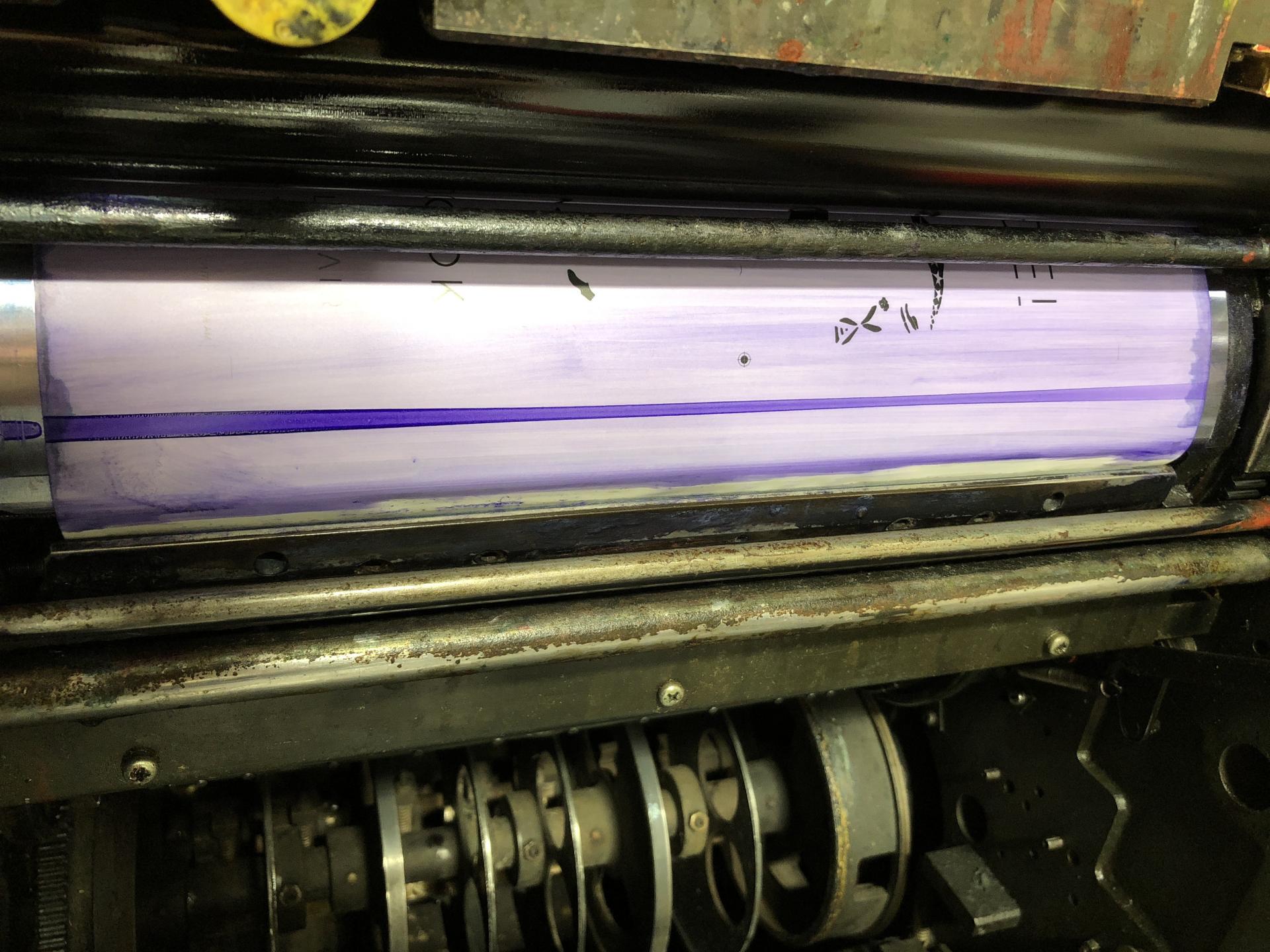

- The ends of the Crestline pan roller have droplets of water on them, like the roller is not properly inked.
- When I look at the water form to plate stripe (picture attached), the stripe is thin in the middle and larger on the edges, instead of one even stripe all the way across
There's a big difference in the amount of ink across your roller. Could be because it's swollen, as you mention. There's a lot more ink where the strip is thicker.
If swollen, the only cure is to replace. Avoid using strong chemicals to clean the rollers. Or at least use any strong chemical as infrequently as possible. It contributes a lot to swelling.
Thanks, Keith. Yeah, it does seem like the ink is heavier on that side. It might be because in dabbing a light coverage of ink for testing purposes, I just went a little heavier on that side. But the stripe looks the same with even inking. For cleanup, I use a vegetable-based wash called Brigl. It's great stuff that just needs to be followed up with warm water to get rid of any residue. In any case, I realized that the Crestline rollers haven't been changed in four years, so I ordered those yesterday and will install them when they arrive tomorrow. I'll be sure to post an update once all that is done. I appreciate your response.

Turbotom, the uneven stripe was really only with the water form roller. The ink form stripes all looked good. The form-to-oscillator is only ever about 3mm, if I'm remembering correctly. (But not at the shop now so the settings I have written down are not in front of me.)
The update I have now is that I swapped out all the soft Crestline rollers on both heads as of Friday. I then set all the pressures—the water form pressure looks amazing now. So I'll do a full inking of the press on Monday and try to print, and see what I've got.
