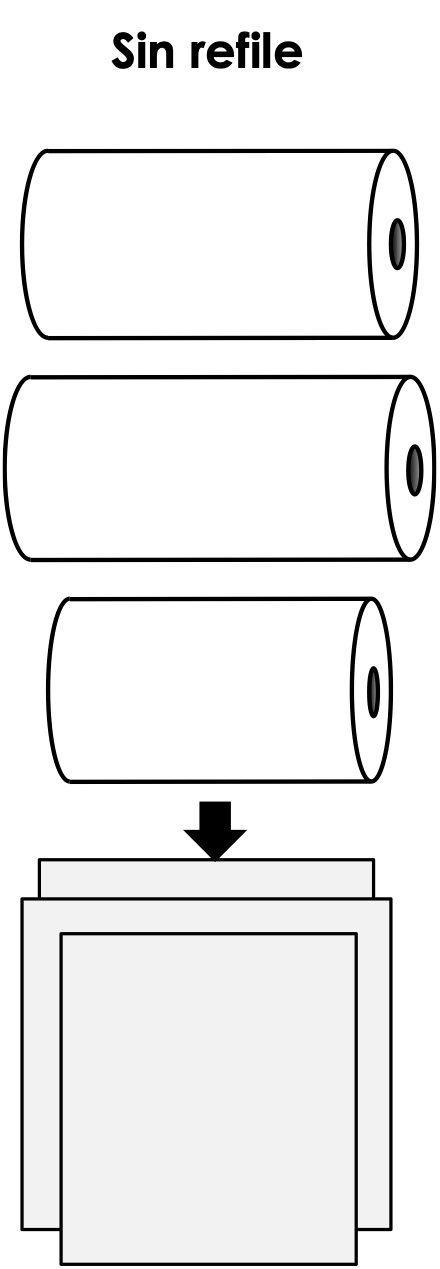

When sheeting multiple paper reels there is normally some width variation within the reels (+/- 1/16"). Because of this, the width (normally) of the resulting paper sheets may have the same variation causing feeding and register problems at the press.
In order to establish adequate paper dimensions tolerances. What would be the maximum variation in paper sheets width that allows to print it without problems?

Wherever possible we run long grain on press, meaning the cutoff would determine the sheet width rather than the reel width, in some cases short grain may be required for binding requirements. Either way, we expect sheets to be within 1mm of specified size in both directions. Most mills will perform a final guillotine cut and not pack stock direct from the sheeter.

Side guide pull on press of 1/4" should accommodate most roll width size variation.
