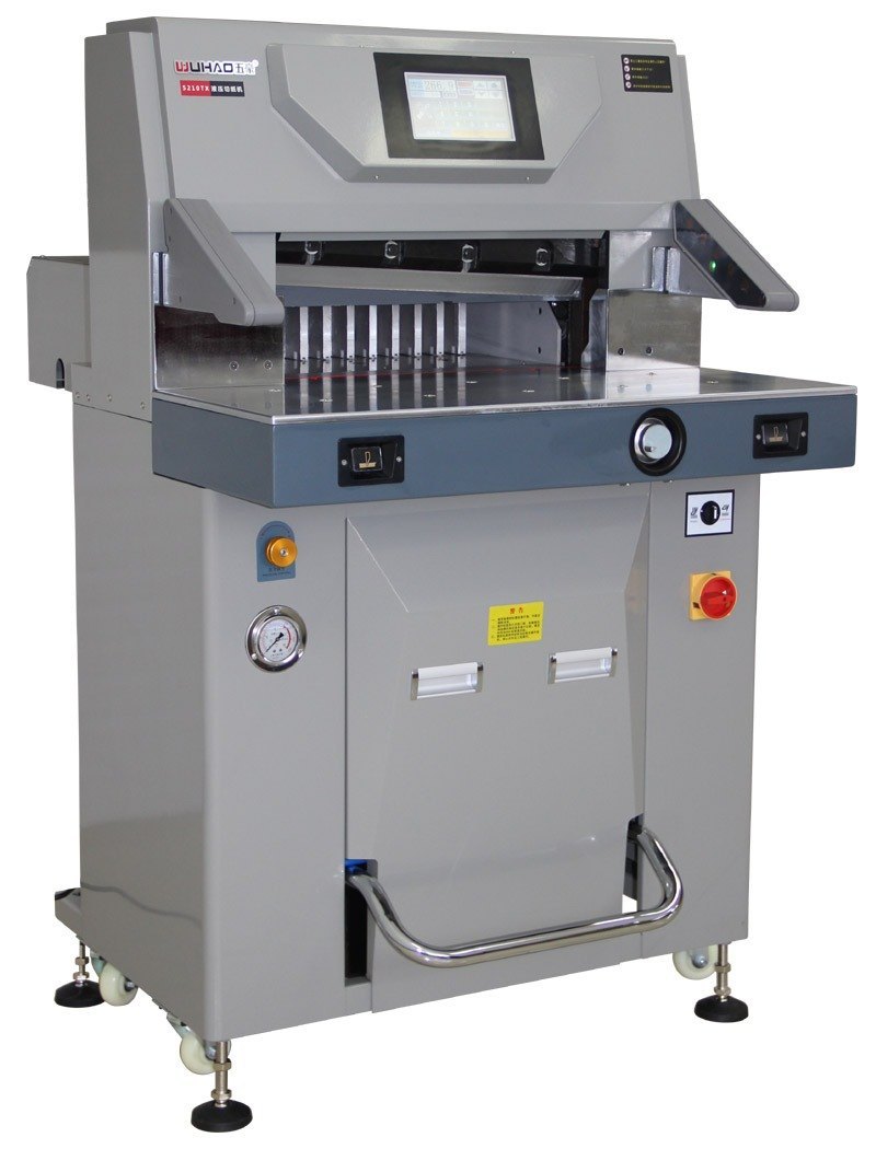

1) Chinese Hydraulic Cutter (BP5010H)
• Programmable backgauge
• Hydraulic clamp + cut
• Fast + easy to use
• Price: ~$2,800–$3,000
• Tested it — cuts are clean

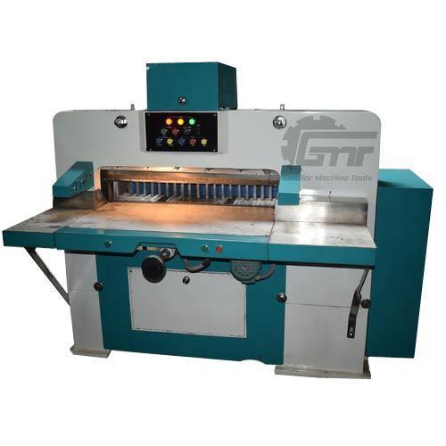

2) Indian Semi-Automatic Cutter
• Manual backgauge entry
• Manual DAB/clamp
• Not hydraulic
• Built like a tank, long life
• Price: ~$4,000–$4,800

I’d buy neither. The guillotine is the most used therefore most important machine in any shop. It’s also the machine most likely to cause a life changing injury should it fail mechanically or electronically. On that basis I’d buy neither of those pieces of cheap junk. Buy a Polar, Mohr, Ideal or EBA cutter.
Think about service and parts. If it goes down how far away is the fix. I had a customer who bought a cheap cutter. Company who sold it was in NY but they didnt stock any parts. They had to get them from China so customer was down for 3 weeks.
Plenty of old reliable cutters still out there.
Since it's specifically for trimming books, why not get a 3-sided book trimmer instead? But if you're sticking with a single-blade guillotine, programmable is always better so it can automatically move from one cut to the next, saving you lots of time (and mistakes).
Sir, sure the live is very hard, thinking well in your business for tomorrow or later,...
Never look how much it costs, but how much you get benefits...
I don’t have any experience with either one of these but, I would buy the brand that is most used and serviced in your area/region.
A few years ago I bought a Chinese made corner rounder and it works great, but it doesn’t have any electronics on it like a programmable cutter will. My EBA cutter is about 45 years old, is not programmable and I never have any problems with it. A programmable cutter will make your life easier though.
