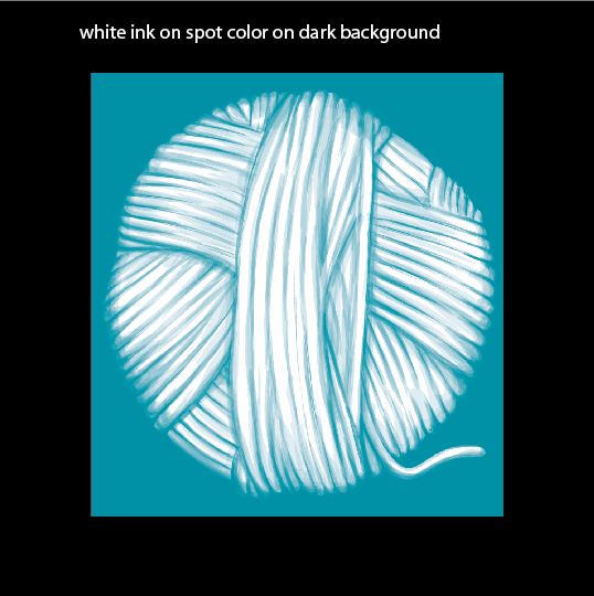

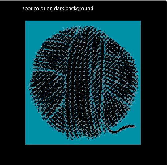

I thought this was going to print in WHITE--now you are saying you want to print in a spot color--that makes this whole process different--because--IF you want the 'yarn' to be white on a colored background (dark fabric for example) it would need to be printed in a solid spot color and then printed over the spot in white ink--IF you want it to print in a spot color and have the background show through--then the white illustration would need to be 'knocked out' of the background and the yarn would be the color of the background (and this) would require that the art be created in an entirely different fashion--see attached and next post also
We misinterpreted that you want to print in white.
In such case what you have original AI file is good as is.
Printer is asking for EPS probably thinking you might have vector version for highest quality printing, in your case your Yarn has shades so the vector is out of question.
Tell them it is all you have and it will be fine or seek another printer.
