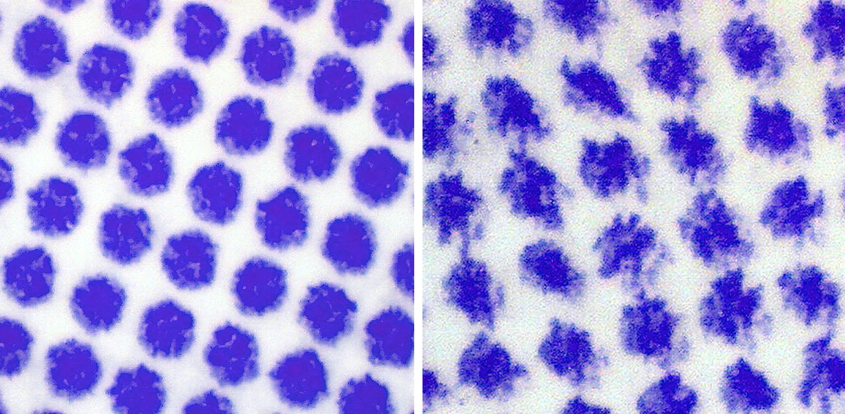

Can you post a micro photo of the slinging you're seeing? That should clarify what you mean by slinging and it will probably reveal what the problem is.
This is what I mean by micro photo (halftone dots):

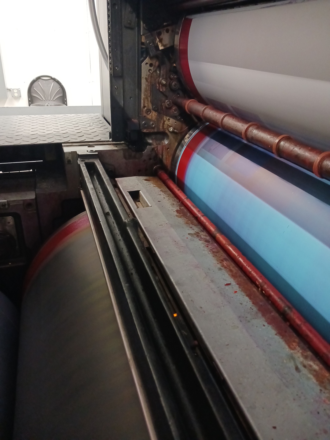

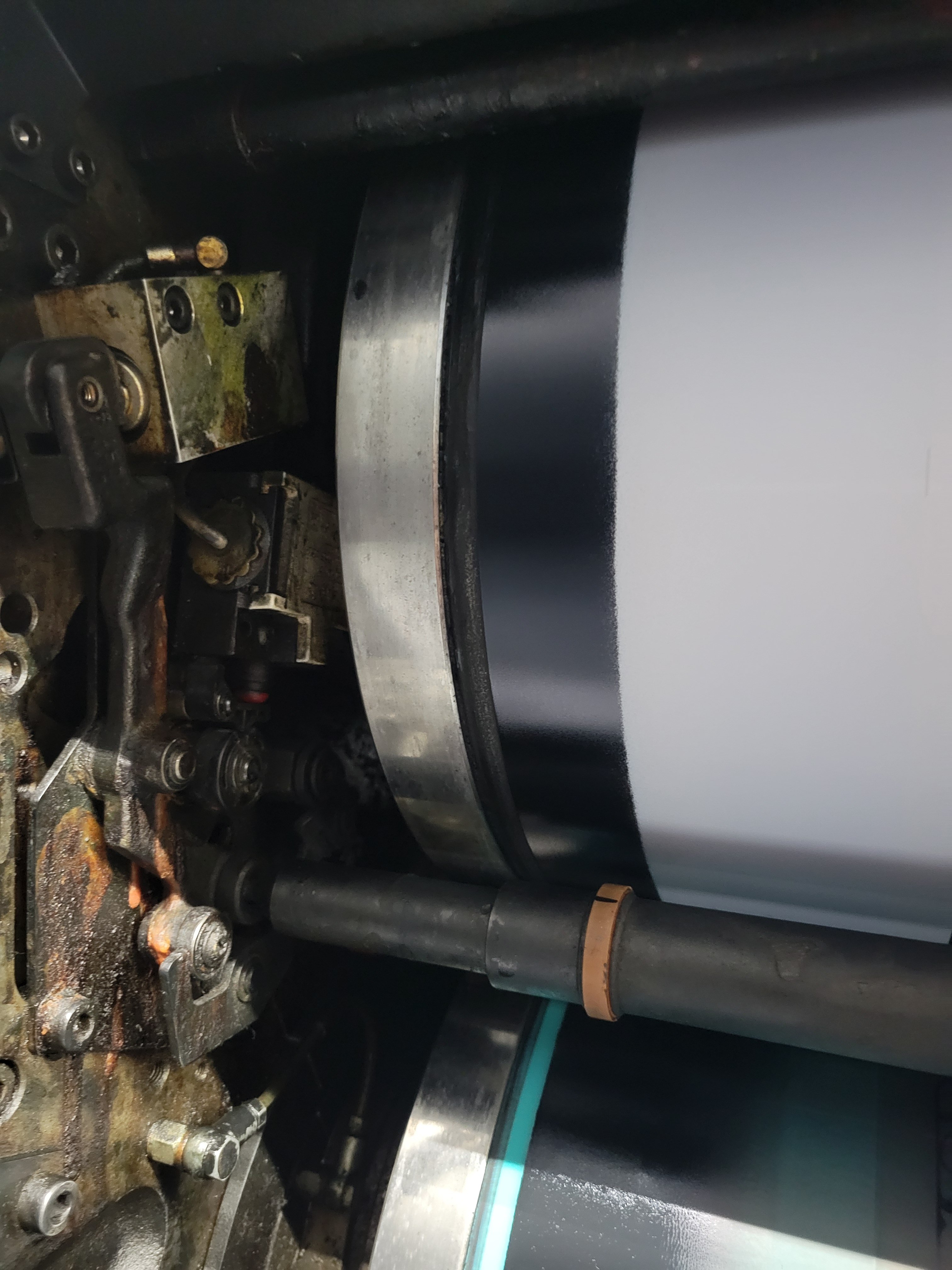

Good day Gentlemen.
I apologize it took so long for me to respond. I have talked this over with a Heidelberg rep and he told me to skew my meters harder. I did and it definitely helped. I honestly think I have two problems on my hands
1. Bad roller stripes
2. We need a different plate.
I will attach some photos and try to respond quicker. Thank you for your feedback.
