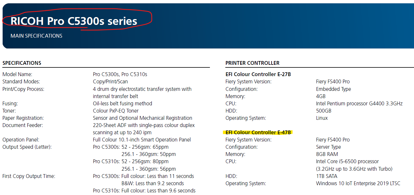

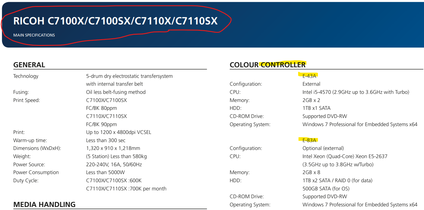

Doubt it as that controller is listed only for the C5300 series. The C7100 needs the E-43A or E-83A.
