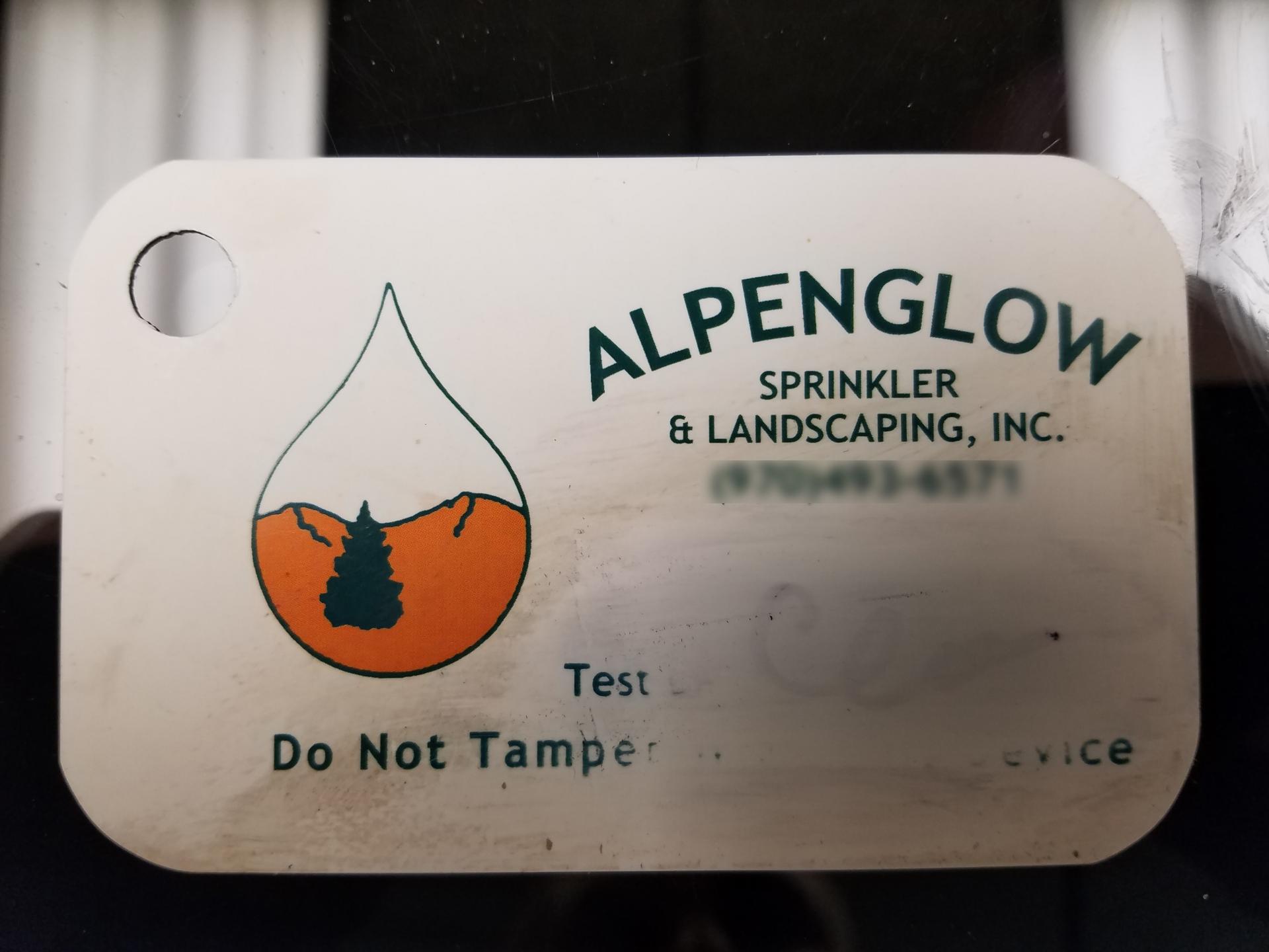

We have a few customers that have switched over from laminate to digital polyester. Some of these customers are writing on the digital polyester. They are putting dates, prices, and other information that they want to wipe off and change later. Most of the markers they use will smear and wont come off with water alone. They end up trying a heavy cleaner that takes off the toner. Is there a marker, pen, or other writing utensil that works best with this material? Or is there a cleaning product that will take off the marker and not the toner? We use Nekoosa Coated Thermanent Digital Polyester and printed on our KM C1085. With these certain customers we end up going back to laminate but I would like to figure out a way to keep them on Digital Polyester. Any help is much appreciated!
We have tried dry erase. It almost becomes a permanent marker on the Thermanent. Kind of seeps into the material and doesn't come off with dry rubbing like it should. We can get it to come off with some vigorous rubbing, our finger nail, and some water but it also removes the surrounding toner.
I attached a sample of what we are working with (blurred out the contact info). You can see the toner/text next to the area he writes comes off with rubbing. Also the residue that gets left behind when we do. With laminate the dry erase comes right off and the text is protected since it is sealed. Just wish there was something I could do with the polyester to make it work as well.

I purchased a grease pencil/china marker and that did come off with just a few rubs without taking off the toner. It came out pretty light so not my favorite but could be left outdoors since it won't come off with water. I'll try the wet erase tomorrow.
