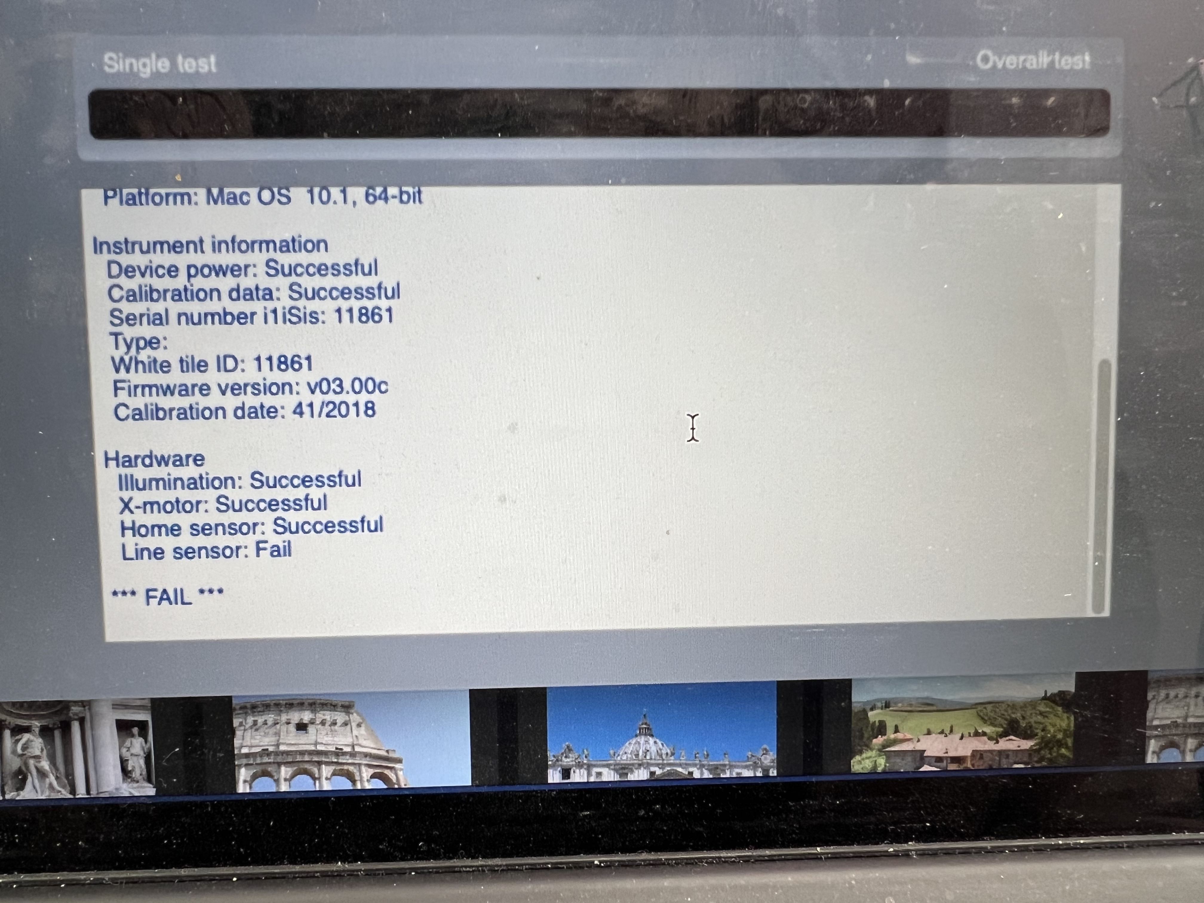

Hoping someone can point me in the right direction. I am using an inherited X-Rite i1 Isis 2. I am getting an error when starting to read a test chart, it will not feed in the sheet. When I run i1 Diagnostics it returns a Failure Promt on the Line Sensor. Does anyone know how this can be resolved? I got a quote on sending ours in for repair and it is pretty steep in my opinion.

They can be picky. try changing usb cable/connection. Put slight pressure on paper (even a slight bow of chart being fed). I am assuming proof is trimmed accurately and being fed in right direction. Mine is quite noisy and beat but, but continues to perform. Good luck
