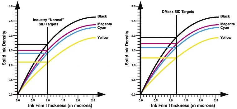

Attached is a chart showing SIDs relative to ink film thickness. Most printshops that I've visited run their presses about 10-15 points lower than the traditional SID targets so going to this density can be quite scary (but enlightening).

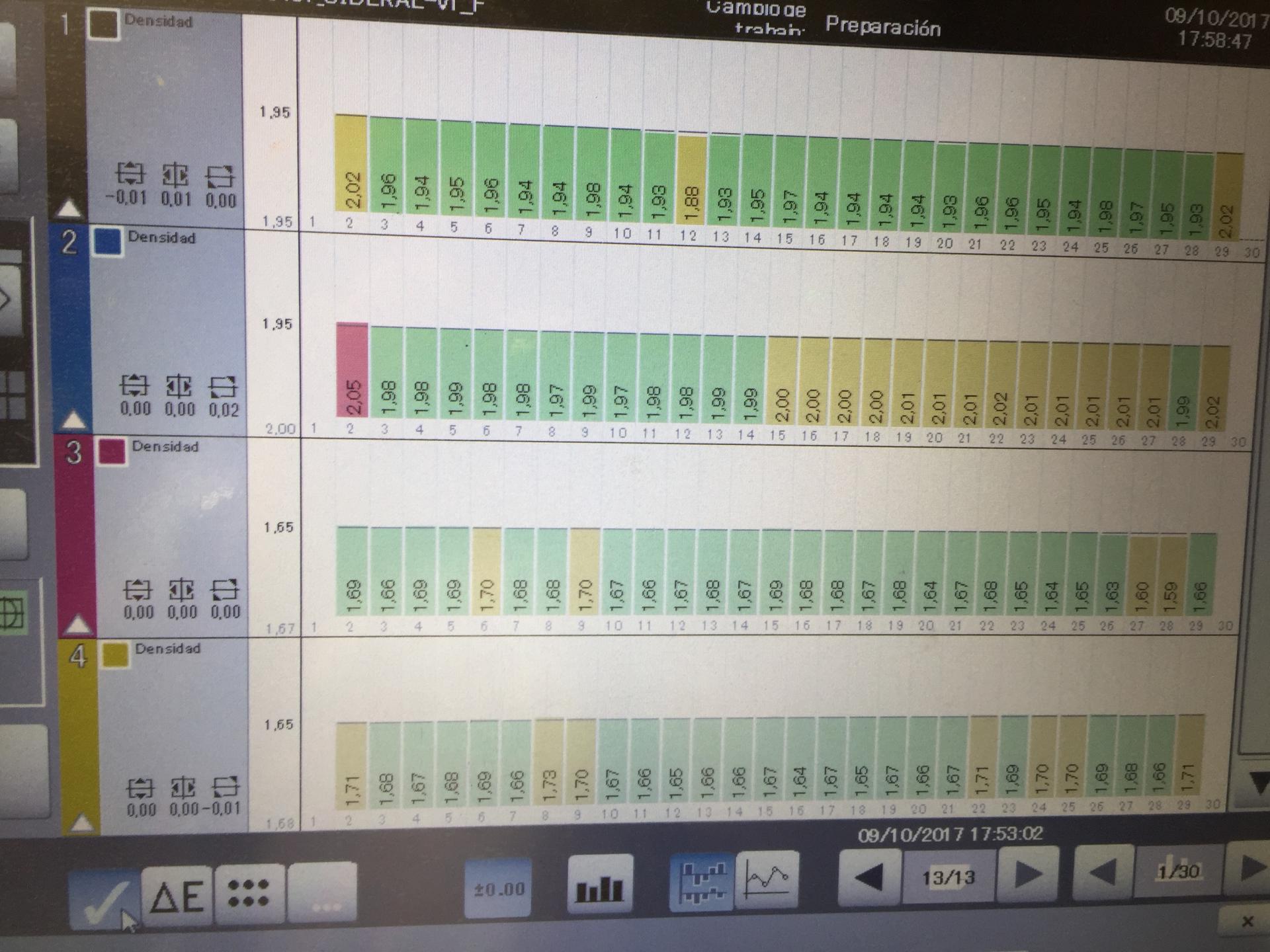

Hi all,
My post does not answer the original question, but for your info and just in case you have some “curiosity” ;)... The pic that I have attached to the post shows the SIDs values we were running when we produced a book with the XCMYK 2017.icc profile from Idealliance. The inks used were from Siegwerk (H-UV Perfect) printing on a Komori Lithrone G40 with H-UV drying system. Note that the densities in the picture (K: 1,95 – C: 1,95 – M: 1,65 – Y: 1,65) are expressed with Status-E, and not using the Status-T filter/response which is the accepted standard in the US. Also keep in mind that the whitepaper from Idealliance says: "the densities may be used as a rough guide to setting ink levels. The Lab values are more exact."
Here I share with you the average CIELAB dE2000 we got for the primaries:
C: ΔE00 3,40
M: ΔE00 2,60
Y: ΔE00 3,20
K: ΔE00 1.70
