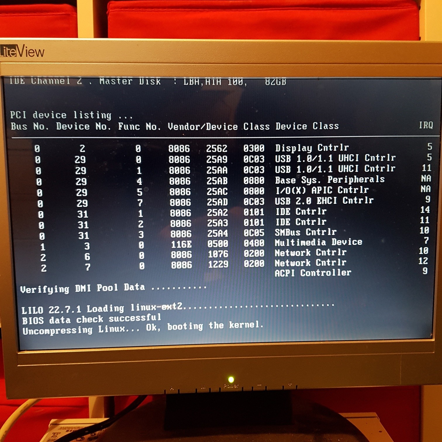

UPDATE:
Hi All
I have lost connection to Bustled Fiery, I have the attached screen showing the status of bustled Fiery, I have been told it could be software issue, does anyone know how to install I have the CD's.
Dan
