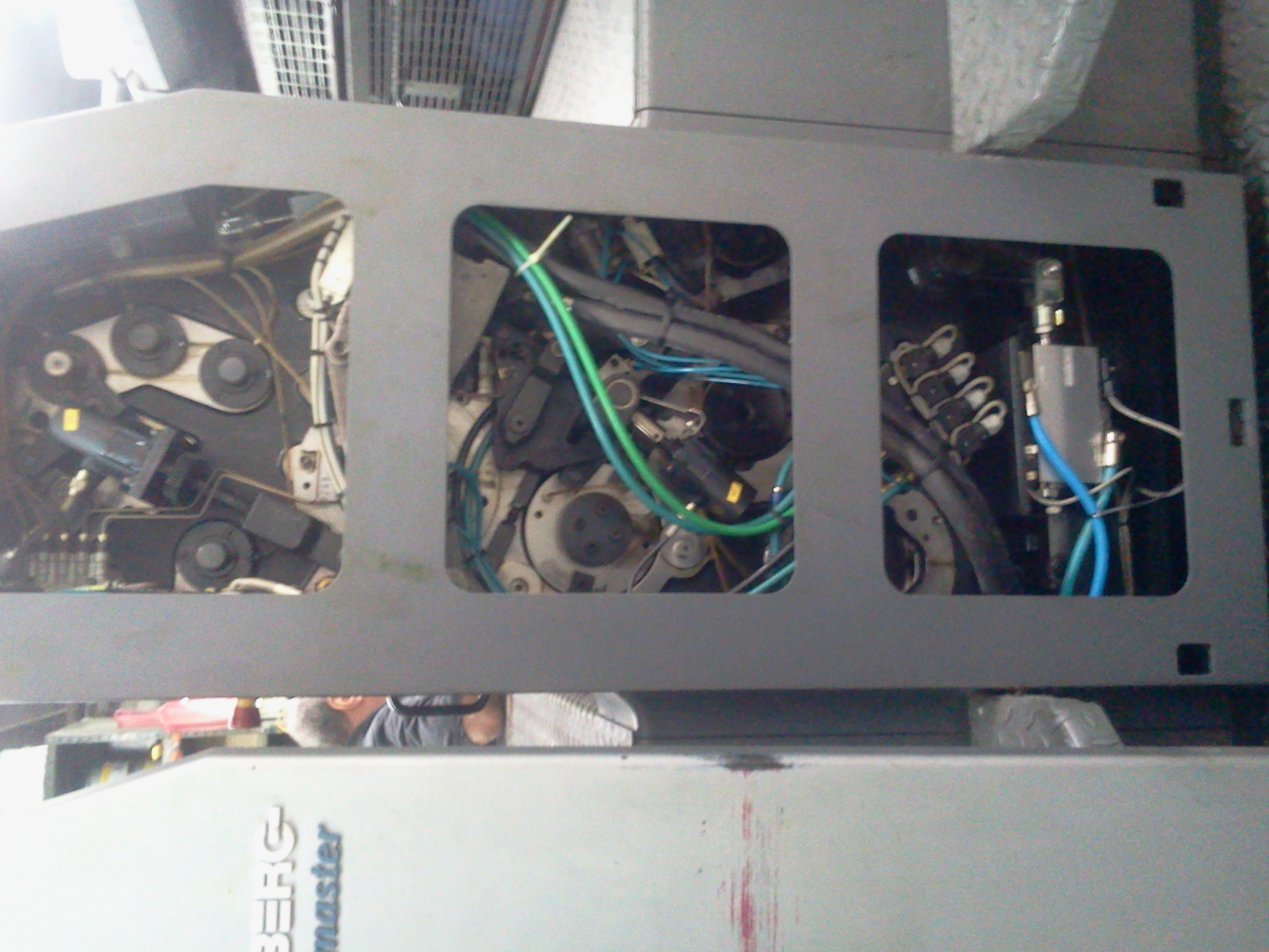

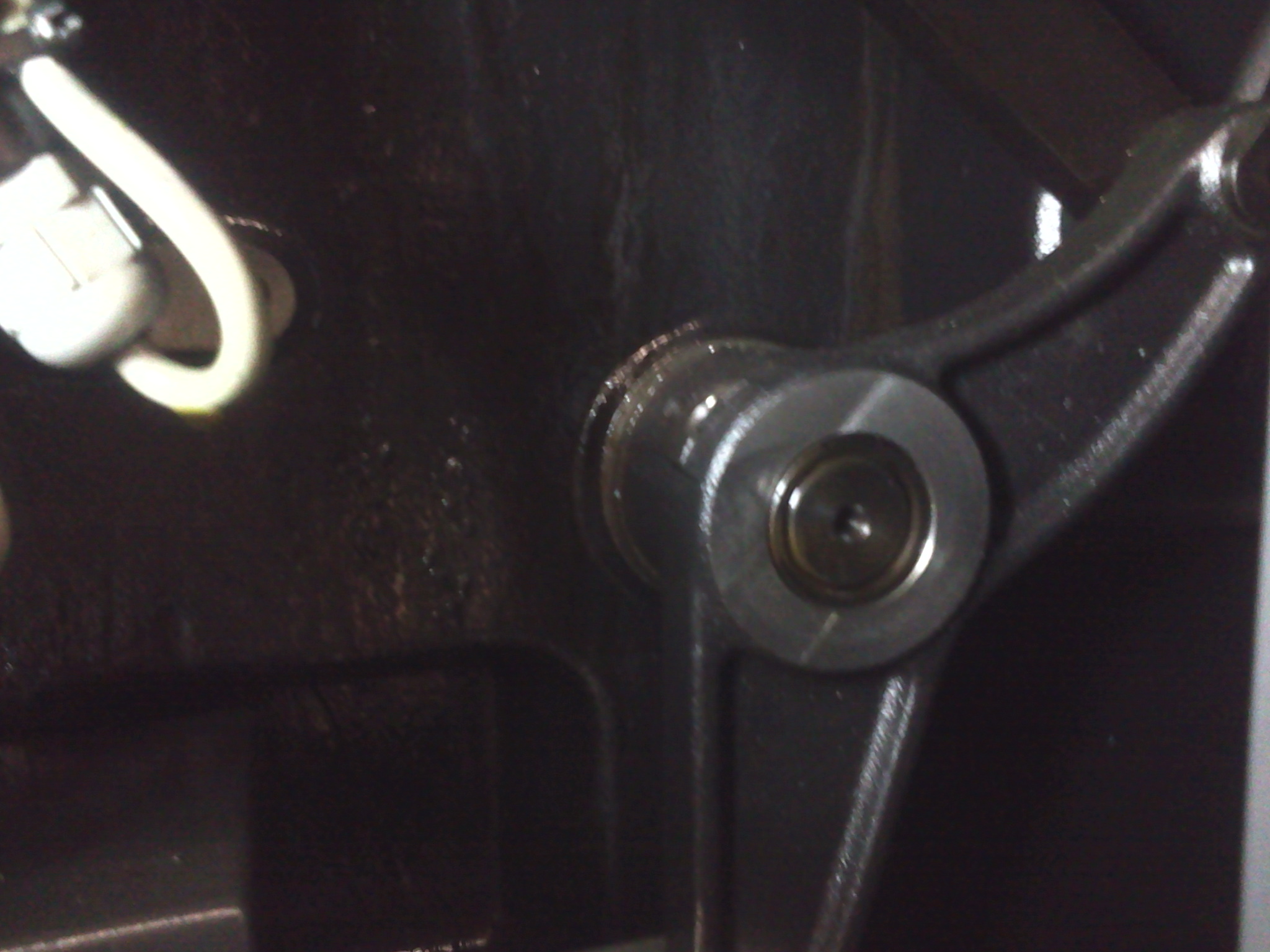

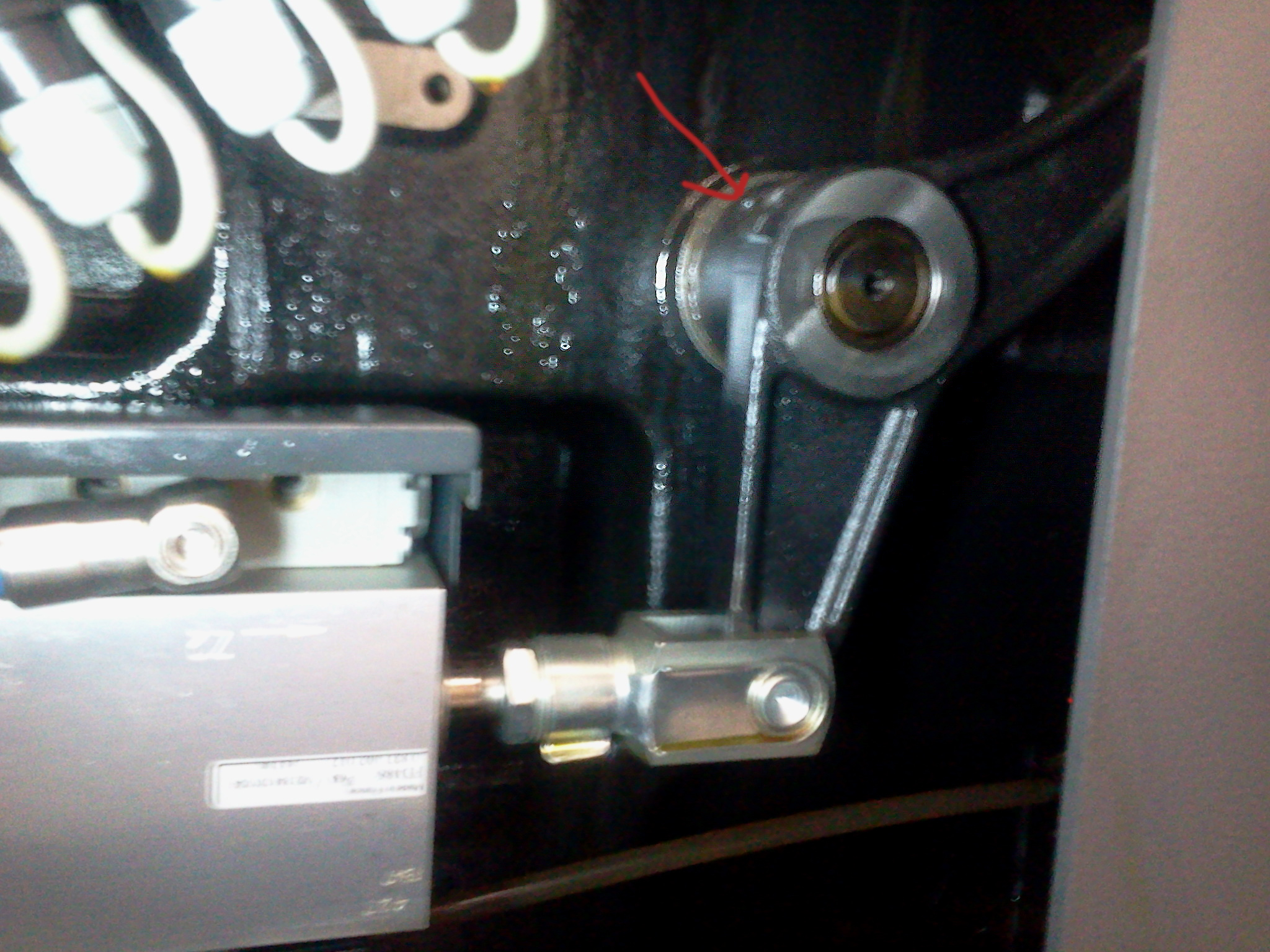

I am not a pressman I asked them and they said if these pins are broke then this could happen on the operator side down on the bottom right side. this is a double pin you will need both of them. You can check this if you tap the pin in a little bit and then try the press. If the press works then replace both pins this is just for a test do not run after the test....

Hi,
Thank you maac and aqazi81 for helping me in this problem.
I am going to check these pins,I didn't think about it before.Maybe the problem is from there.
