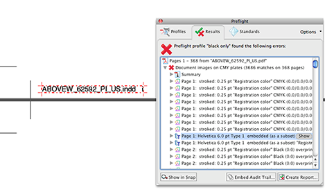

Thanks, Rich. I ran your profile and, unfortunately, I get the same results that I get with mine existing profile. It flags every crop mark, and every us of 0/0/0/100 text. See screen-shot.
I can't seem to find a way for the profile to ignore these elements and focus on art objects, instead.

The practical side of me would create a fix to convert rego colour to greyscale and CMYK only text to greyscale so that the preflight error would not be triggered...while the problem solving side of me wishes to make the preflight work as you ask without a fix. I have not had time to do either.
EDIT: The practical side of me won out, sample Acrobat 9 preflight with fix attached...
