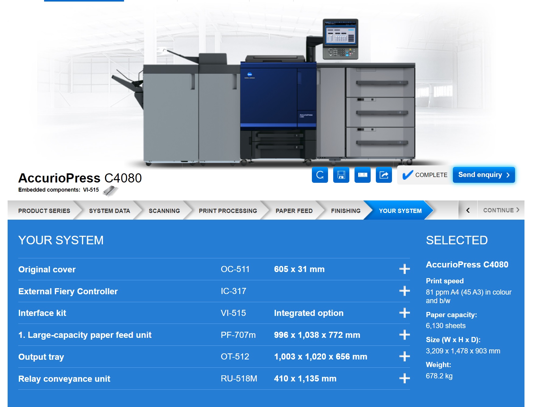

That's a similar configuration to our C4080, except we have KM's own controller (IC-609) in lieu of Fiery.
Look at this unless you're experienced in Fiery, as it's a credible alternative that will save you money.
We also have the LU-202xlm long feed paper deck with optional HT-503 heater.
Do you have an offline finishing setup?
On your other point - it's 2021, don't even think about investing in offset! There are so many shops having gone digital-only over recent years. Offset is dirt-cheap to buy in, so do the artwork in-house and sub out the offset work. It's also hideously expensive to set up, in terms of space, power provision, labour (you'd need a skilled pressman), chemicals process, etc. Just my 2p.

I have chosen IC-609 at first, then wondering, maybe the IC-317 is much better, please enlighten me. Is the upgraded version IC-609 is actually the best one?
I decided to remove the Long tray, as I may not need it much, the LU-202xlm, because I might only actually print books and not know if I'm going to print more than that. The optional HT-503 heater does not exist in my option, will do check them to dehumidify the paper, or it's for other purpose. Thank You Ynot.
I know right, the offset is like for multi-millionaire. And the PaperMill needs more than the space the Offset printer needs.
I see the configuration and the HT-503 heater doesn't exist. Probably should ask for that and request to the manufacturer, than rely on the configurator.

The IC-609 is KM's OEM controller
The IC-317 is efi's 'Fiery' controller.
Fiery is a long-established industry standard and there are many reasons where this will be preferable, mostly where operators are skilled in the Fiery workflow, also for sharing jobs in multiple machine set-ups.
However the OEMs have developed improved controllers of their own over recent years and if, like ourselves, you are entering the market with no Fiery experience, it may be difficult to justify the additional initial expense and ongoing maintenance on a third party controller.
KM's Accurio Print Manager software (used with the IC-609) seems pretty good and I guess we've only touched the sides with it and it can do loads of things we've not even looked at yet.

Thank You. It seems I will need to study more as I have read only the short things about the fiery one. You're right, I must stick with the easier one as I'm going to be a complete newb to this. Will continue studying these information and things you are educating me about.

The HT-503 is only for the LU-202xlm paper deck
The heater option for the PF-707m is HT-506

Thank You, I am trying different configurations in EU and your choices did showed up, the heater and the paper deck.
