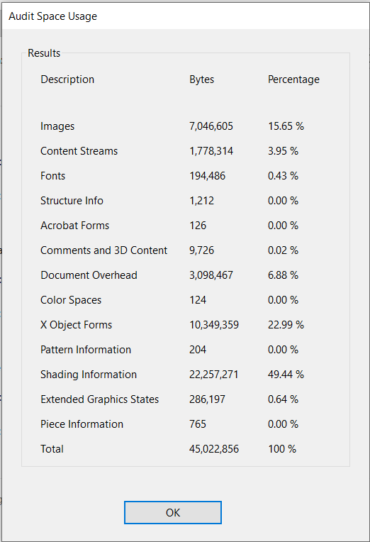

I tried your suggestions, but they didn't seem to help with speed. I am attaching a file showing the document space usage. Not sure if that helps.
The redraws are painfully slow. I have a 3060 nVidia GPU. Ripping time isn't too bad, tends to take around a minute or two.
The output of the Audit Space Usage is exceptionally helpful!
What dramatically stands out are the 22 megabytes of “shading information” representing nearly 50% of the file size. This may be indicative of a tremendous amount of use of smooth-shaded gradients in your original source file (or content placed therein), much more than one would normally expect to see in any graphic arts content.
Quite frankly, if you could post such a file, I could examine it and try to ascertain exactly where the issue is coming from (i.e., what objects are triggering this).

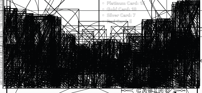

Pretty interesting. I ran an Acrobat/Callas inventory on this SINGLE PAGE file.
Resulting report was 12,000 pages long!!
8826 XObjects
3427 Smooth Shades
2 Patterns
149 Images
35 fonts
And Wireframe view shows where those shadings and vectors are used!
Can try a few tricks rasterizing the vectors and blends, but that's going to take a while.
That's some sweet action. That's like dumping a box of pasta on the floor and saying you "designed" the resulting mess. 35 fonts on one page...really?
This was designed by an ad agency used for several of their properties in this area based on the East Coast. They are a pleasure to deal with and always very punctual in getting us art, but I have long felt that their files were overly complex.
