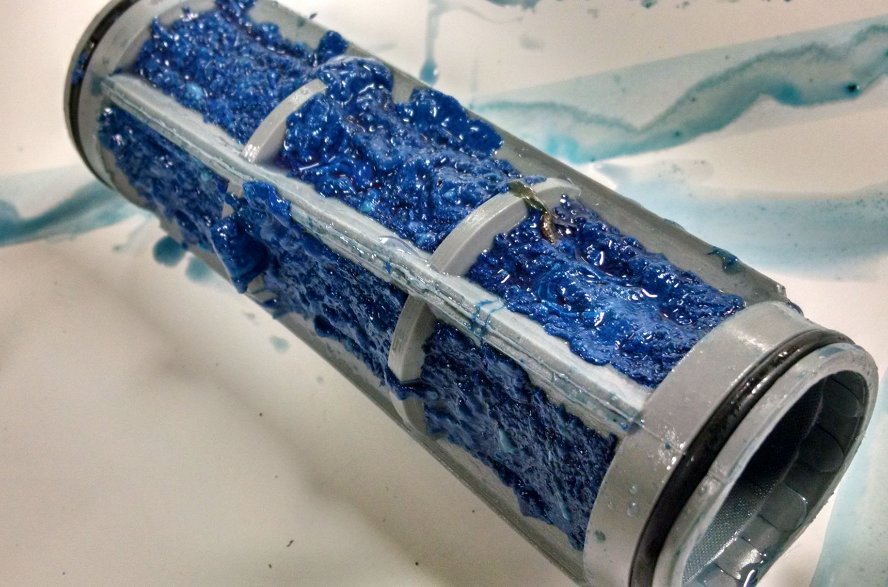

We have an Azura C125 rinse gum unit (processor) that is about 4 years old now and we're having a couple problems with it.
First issue is that Agfa changed the chemistry of the TS Gum a while back and since then we're getting a thick blue sludge in our system that is a real hassle to deal with. The filter needs to be cleaned daily (depending on use) otherwise the sludge builds up on it (see photo). I've contacted our Agfa reps and at first they had never heard of this issue, but after repeated contacts they must have escalated the problem and they came back and said they have a cleaning solution called Azura Oxy Cleaner. I'm still trying to find out what it is. They gave me a price for this stuff $283.50! Judging from the description it might be 16 bottles of the stuff, I'm still waiting to hear if it is. I'm not ordering it if it is 1 bottle.
May be time for a good cleaning including circulation pumps, plastic pipes, drains and all. Put everything together, run without filter, fill with water and make sure it circulates properly. If there's a spraybar in the dev section make sure you clean its holes with a toothpick at every chemistry change. Confirm with Agfa it's better to use 200-300 micron filters (the one pictured is fully clogged).
