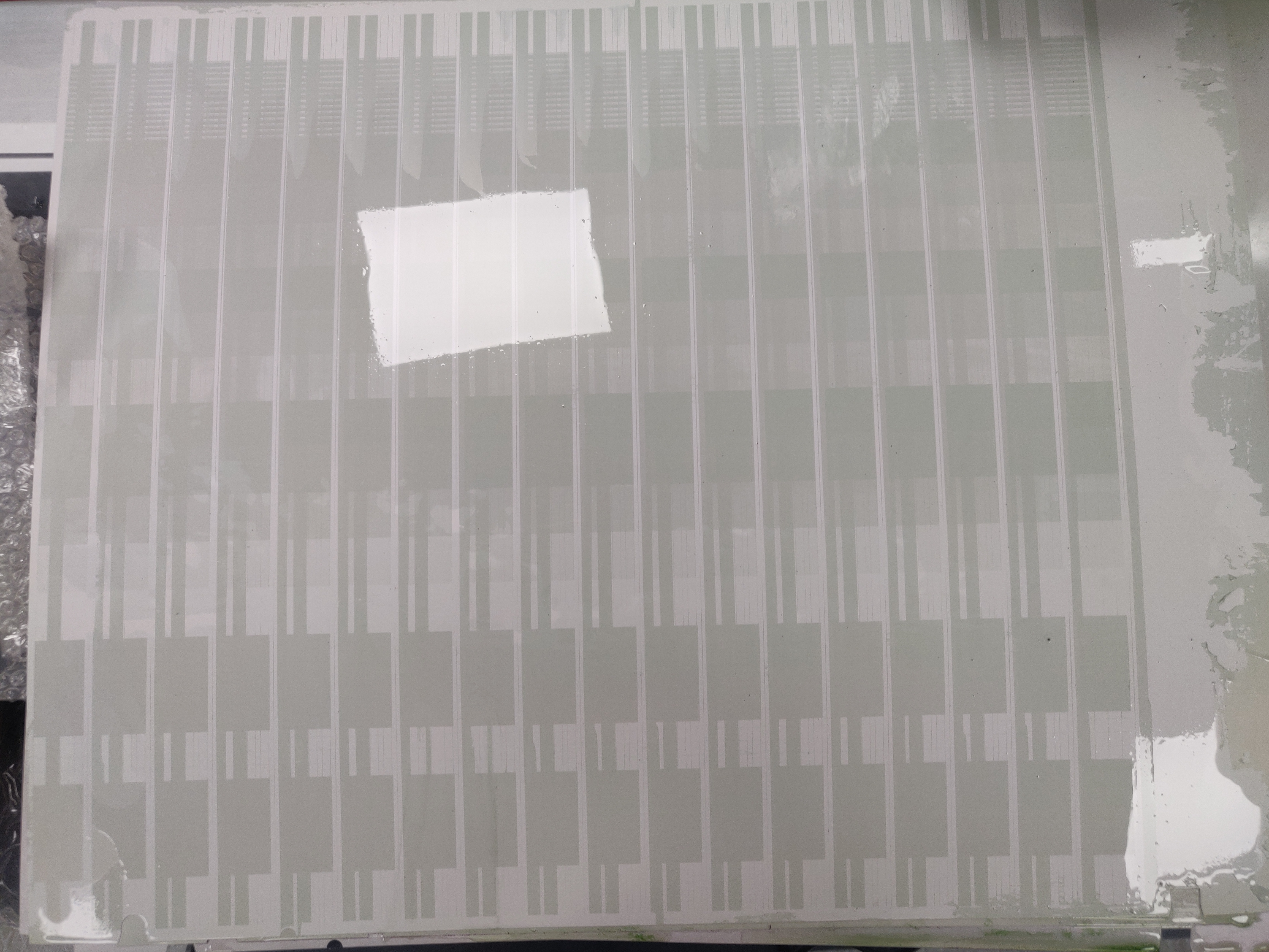

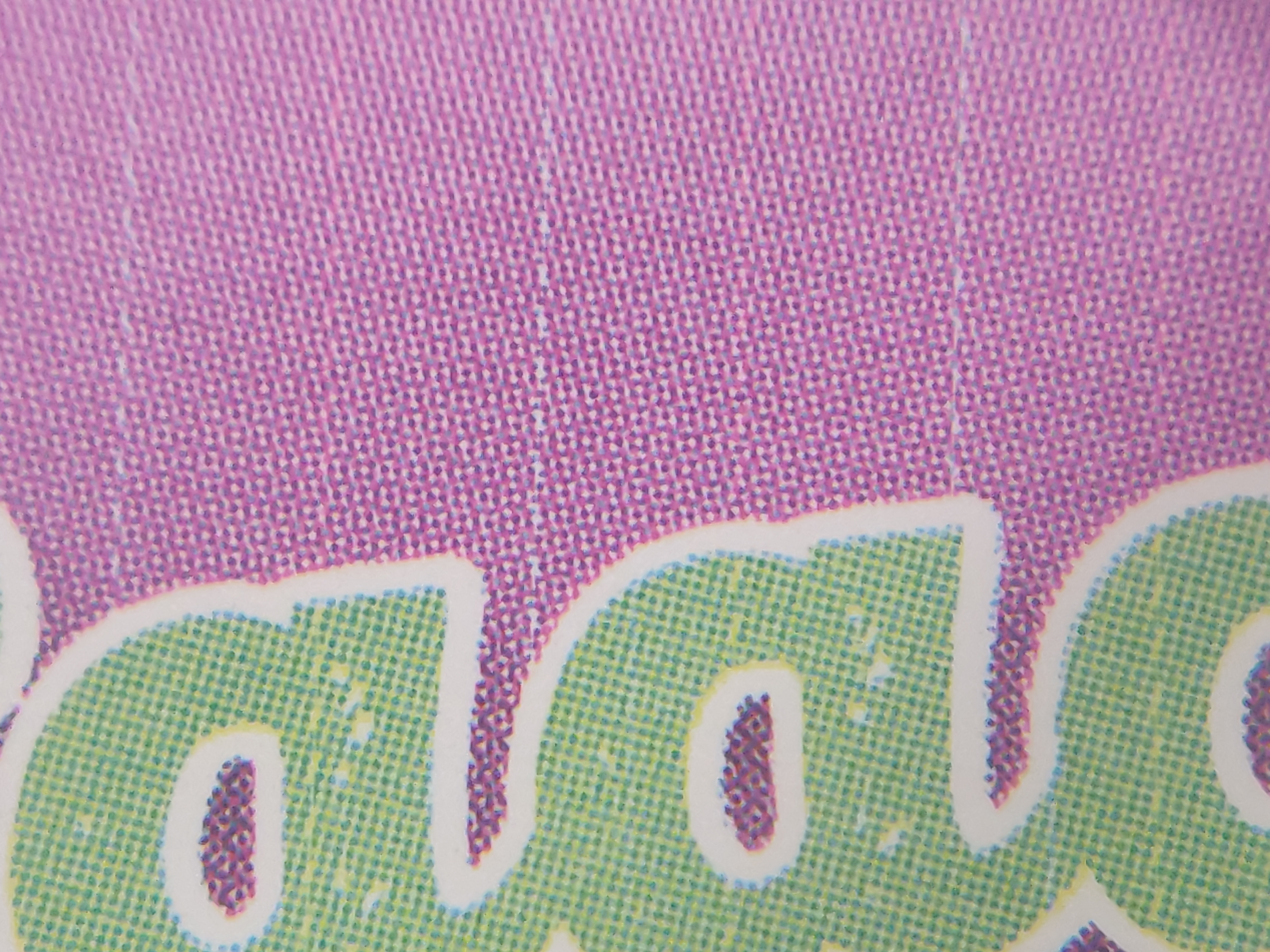

Can someone explain to me why the zoom/focus test STD patters on negative plates come out looking like this:
https://www.upload.ee/image/15355548/IMG_20230619_161525.jpg
While the same pattern/test carried out on positive plate is normal:
https://www.upload.ee/image/15355561/2023-06-07_16.36.38.jpg
Problem with zoom looks like this. Although if you see video on motor backlash, it makes sense why this can be. Zoom lens must be so said glued in place when motor not working.

Zoom motor may be ok. Wrt to test patterns recheck the media type set as nega.
It's NOT ok. Zoom must hold, just like on your camera lens it must be tight seal, not self wondering back and forth. Gear are worn in gearbox not motor it self. That's why there is backlash.
You know i doubt we'd face so much trouble for month if we forgot to set media type to nega. But yes believe me, it's set to nega. Already made many more profiles, hopping it's memory error or media slot glitch or conflict and none help.
