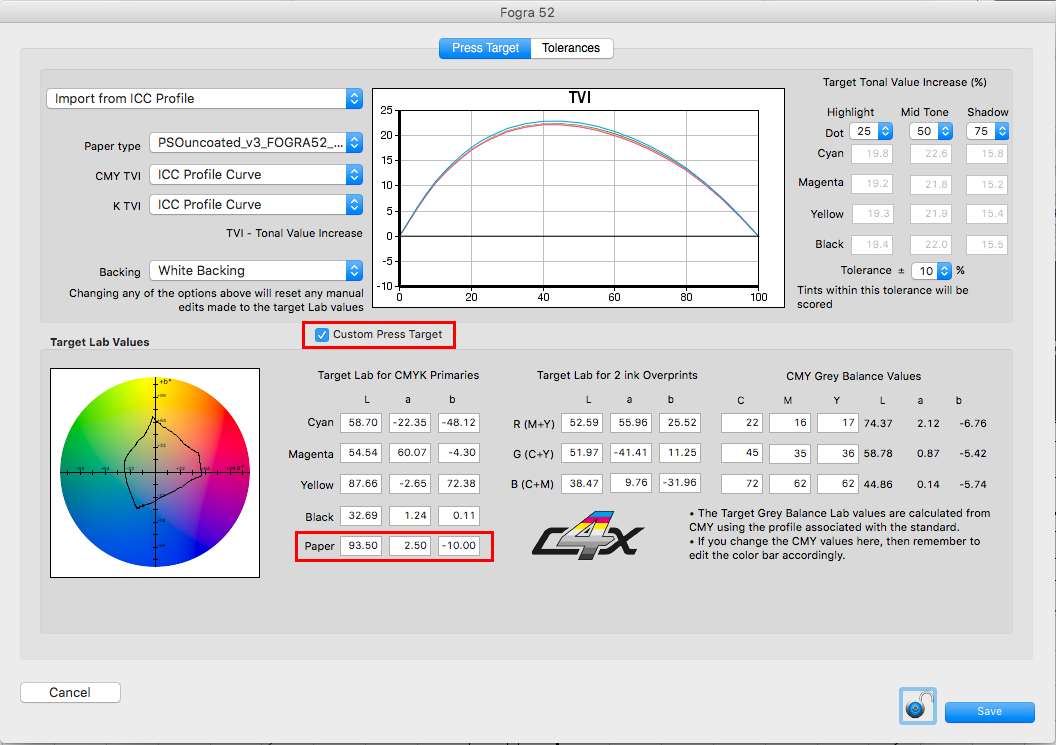

Re PressSIGN and white paperpoints that do not match an ISO 12647/2 based standards and profiles, in this case a Fogra 39 based profile. You can use PressSIGN to remap this white point to the white of the recycled board. Then you use this as the target in PressSIGN. It also allows you to export and revised icc profile which can be used for proofing and seperation if needed. Check out the PressSIGN manual for more detail.
Paul is exactly right: pressSIGN does not restrict you to any particular print conditions: All targets including white point are editable. This is true whether you build the standard manually, import it as a prebuilt set, or extract it from an ICC profile--there is still that check box in the press standard editing window that says "custom," and it allows all fields to be changed, including paper Lab.

Her is a screenshot of the settings window from pressSIGN.
