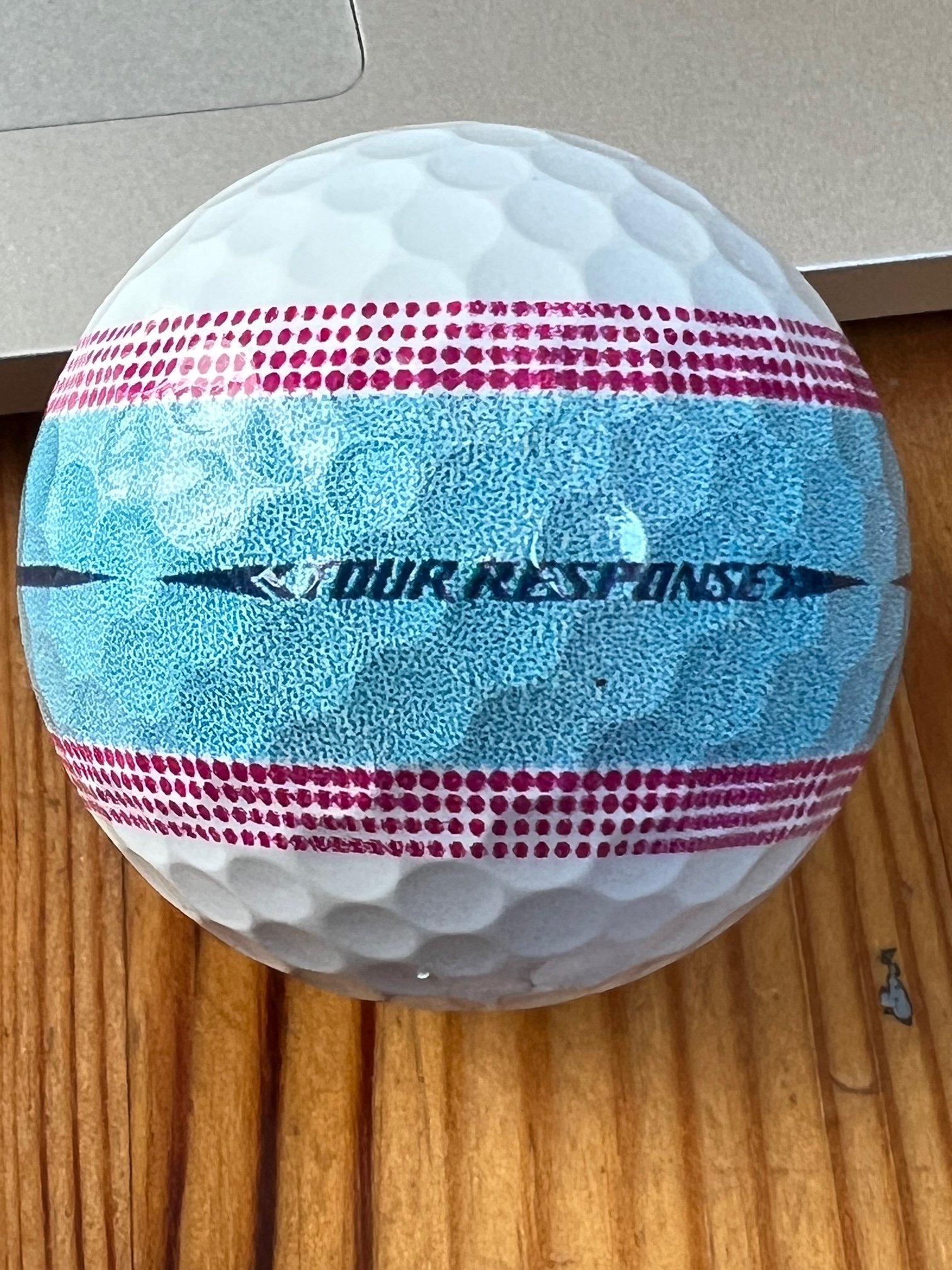

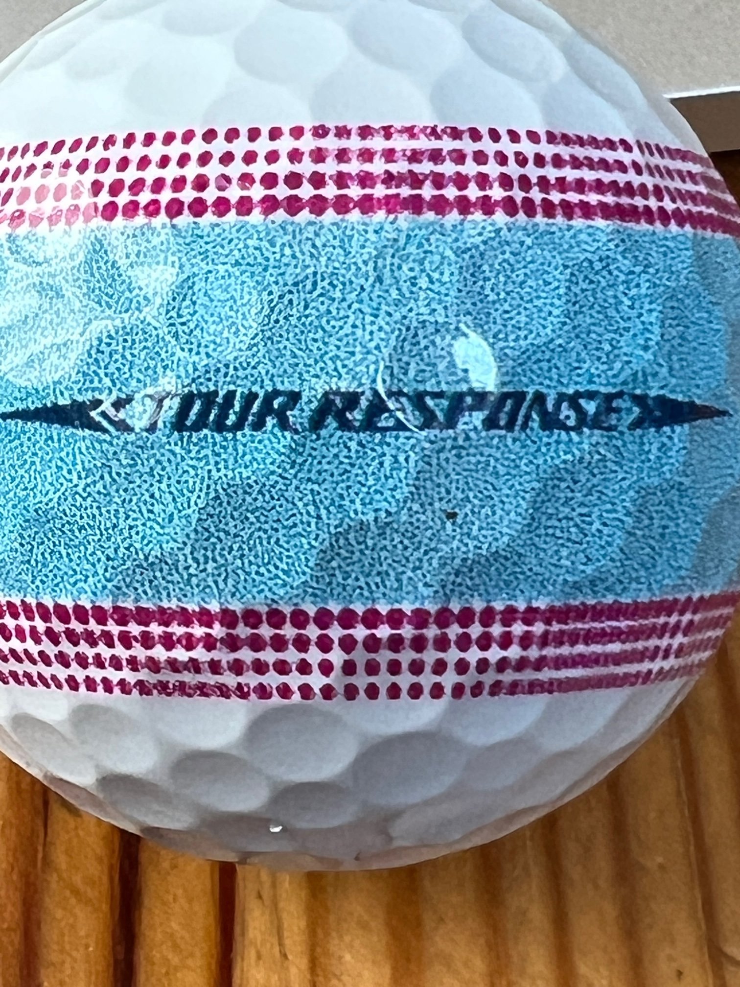

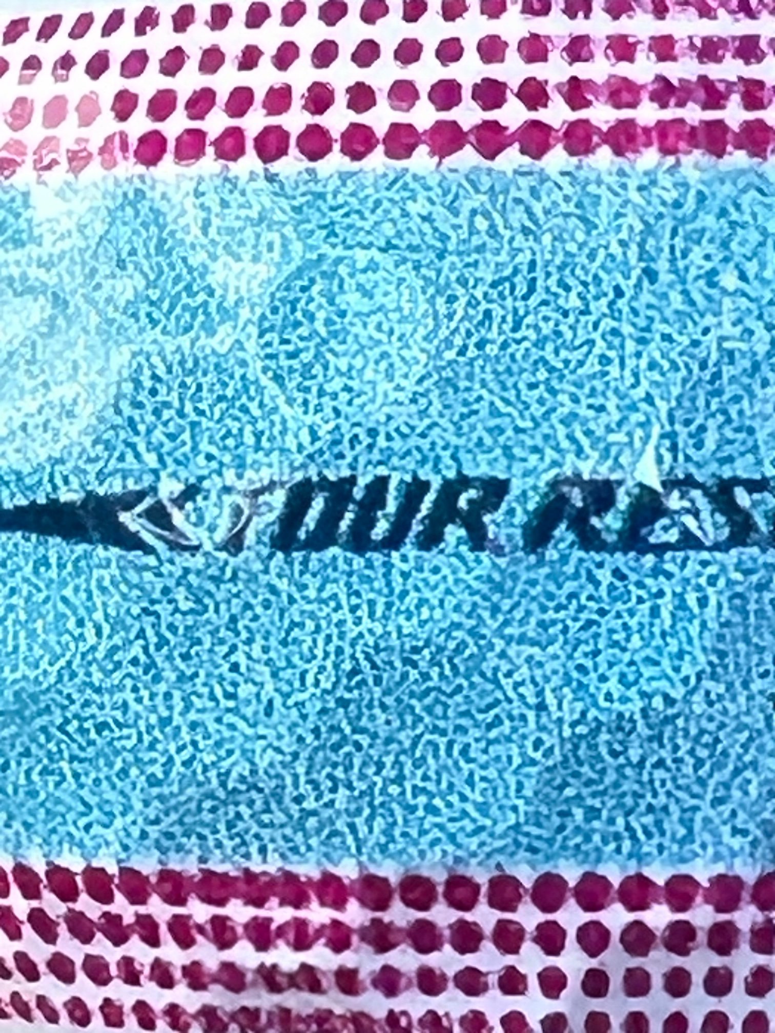

Recently I picked up a Golf ball and noticed that it was Digitally printed. I am stumped at how this is possible. As many of you know Golf balls have several properties that make this process very challenging. First they are round, secondly the dimples and third since they are round I would think you would notice the start and stop of the print. How in the devil is this done? I know many golf ball logos are pad printed but these balls have a noticeable stochastic pattern, which make me think digital. Looking at the ball with a loupe the copy where it says "Tour Response" does not go in and out of register as it hits the peak and valley of the dimples as I would expect. I am thinking there must be a printhead that has a some curvature to it. Photos do not do it justice.

This may be the device. I am still trying to wrap my head around how they can calibrate a device to print so well on a convex surface along with the peaks and valleys of the dimples and the registration does not really suffer.

Thank you, I did see that. It looks like this printer would be good for printing logos. The pictures I included, while they may not have shown it clearly, the printing goes all the way around the circumference of the ball, that is what confuses me. I think Pippip is on the right path as that device allows one to print the entire circumference of the ball. Still how they calibrate the printing seems like it would be a challenge.

Well. It probably does suffer. Just not a lot.. in the pic you sent it's clear there's a lot of splash in the dimples. It's Ink Jet. but not one that sits 0.15mm high. It's more like 1mm or 1.5 mm or more off the subject surface. Depending on the surface being addressed.
