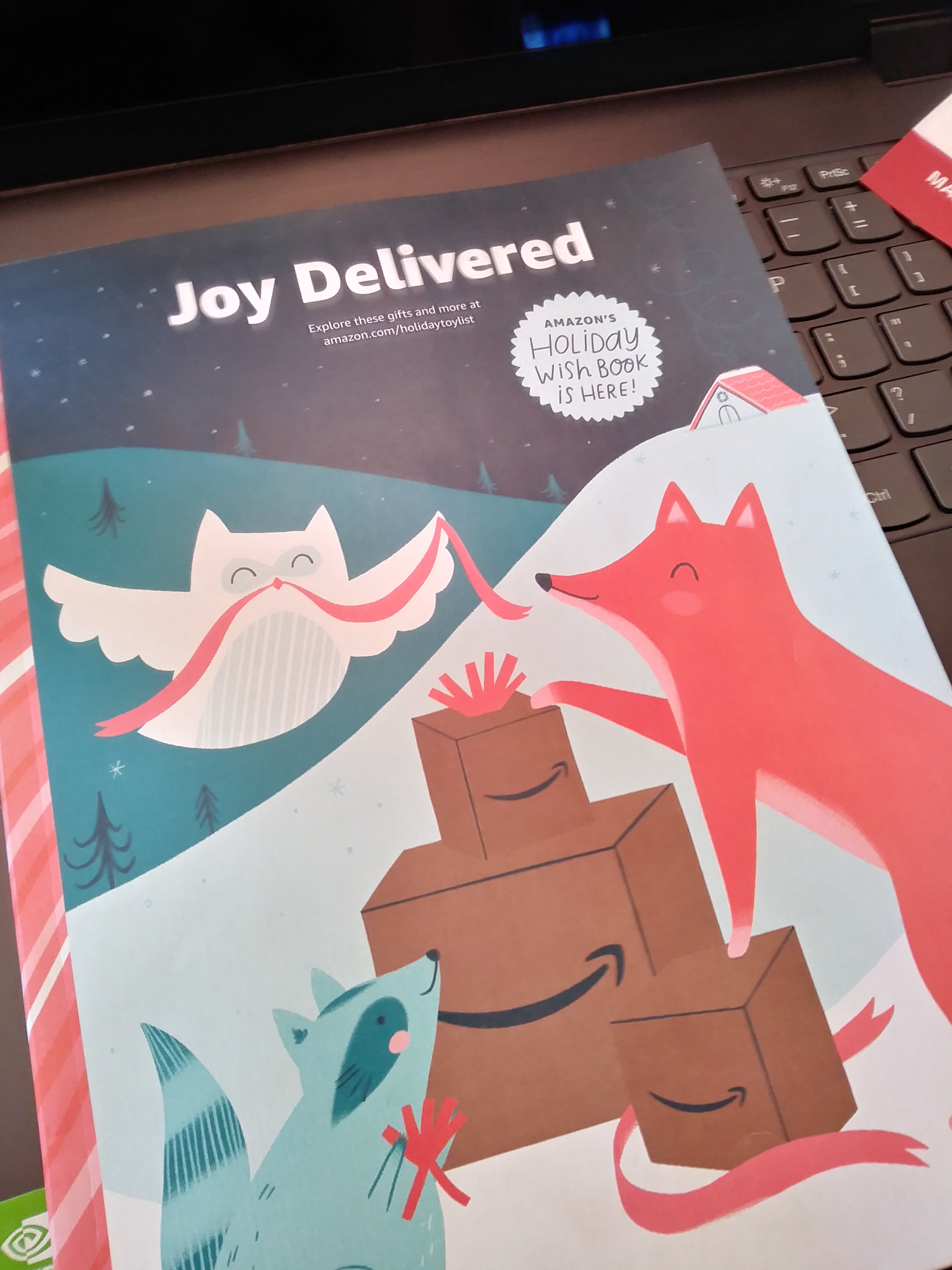

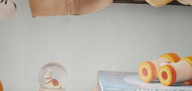

This question is more for fun than anything. I got the Amazon catalog this morning and the dot pattern caught my eye. It is a very fine stochastic screen and I started wondering if it could be printed with inkjet. If it is inkjet it is the finest inkjet work I have seen. Does anyone know what kind of press they run this on? I feel like I can see some sweep lines but can't be sure.

I very much doubt it was printed by Inkjet - reason Long Print Run!
Questions: 1) how many pages? 2) Same paper or different cover paper?

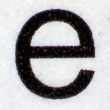

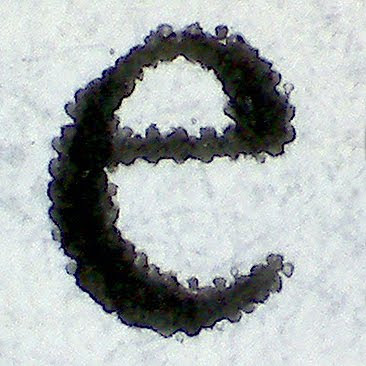

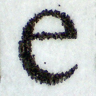

Look at the text under high magnification.
This is Inkjet:
This is offset:
Stochastic screening is very common in publications and catalog work so I wouldn't be surprised if it is indeed stochastic offset.

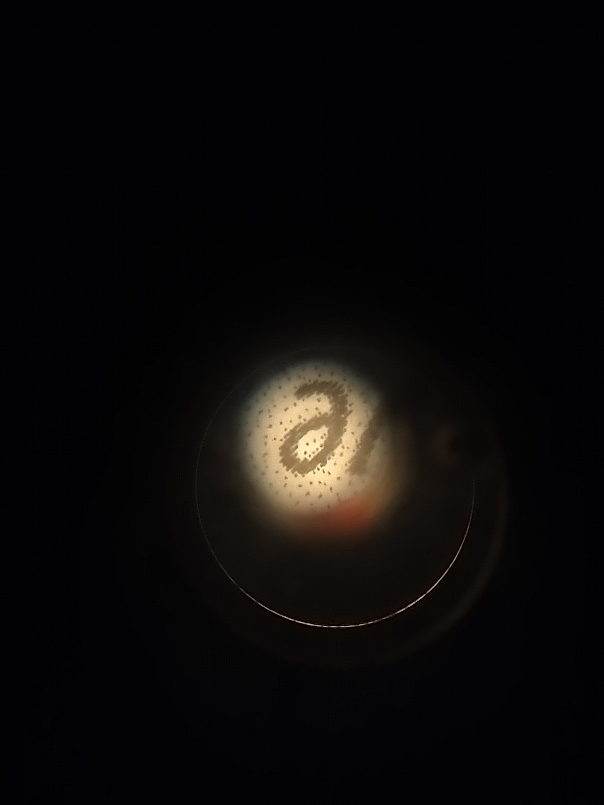

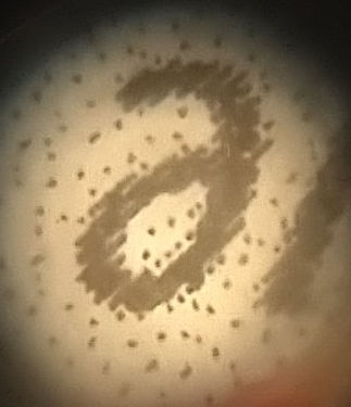

@Alois Senefelder, that is one of the reasons I'd be so surprised, one the quality that looks offset and two for it to be affordable. About 94 pages cover is slightly heavier than the guts but it's probably lighter than 65lb. cover. Distibution is probably every Amazon Prime member in the U.S. @gordo here is a shot from my dad's old 30x Panasonic scope. It is not looking very offset to me :)

Unlikely (though possible) to be gravure.
With gravure everything is halftone screened - including 100% K type. It looks like this:
The images might look a bit like stochastic screening which was mentioned.
printing4me could you post a microscope shot of a halftone screened area so that we can see the dots?

Gravure can look a bit like stochastic. Also it is possible that the cover was printed using a different method than the guts of the piece.

The random dots in Gordo's inkjet "e" picture could very well be what's known as "refresh points". We have control over their frequency of appearing on the output of our Canon ColorStream inkjet printer. Their intent is to randomly fire head nozzles to keep the ink from drying and clogging in the nozzles. They serve a purpose, but are meant to be unnoticeable to the average reader. What is seen in @printing4me's zoomed in pic could be the same at a much higher firing rate, or it could be a very light tint pattern.

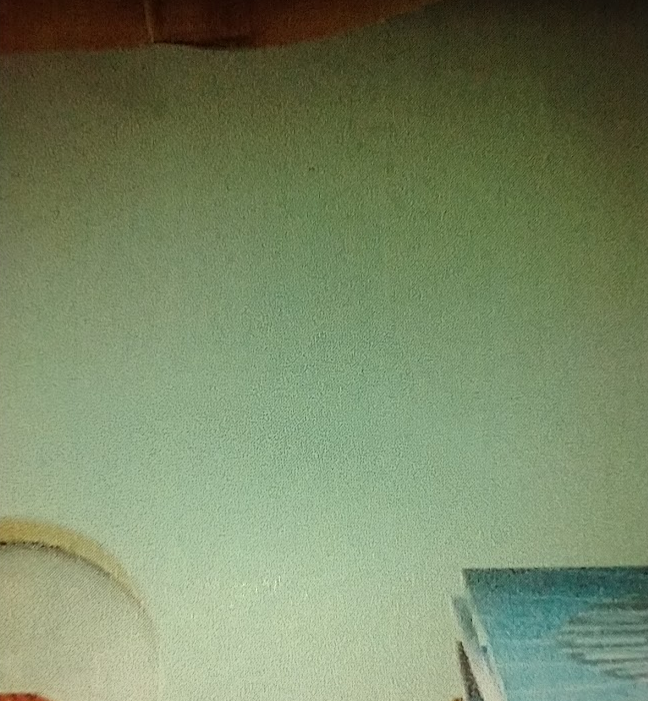

Here are some new images I took. I am voting for some kind of high volume roll to roll inkjet. I'd imagine such a machine would have stationary heads but some of the lines I am seeing that look like sweep lines are things that I have only seen in inkjet. Something like a memjet type of technology. @Alois Senefelder @Magnus59 @gordo @Repro_Pro @Stickman42 We need an insider at Amazon to answer this :)

You might be right. The last image - black screened area? - suggests FM not inkjet.

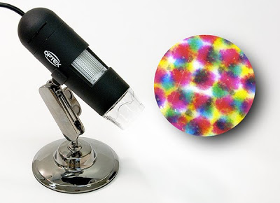

What is needed is a proper microscope (about 20x-200x). One like this:
Very, very cheap on eBay (search for USB microscope). Every print shop should have one.

WE need to see pics of H/tones with Black Text alongside for comparison - some at 10x, 20x and 50x
The examples you submited look like Collotype from the 19th century !

The dots are outside the character are inkjet satellites from spray. It may be a high resolution head with very small drops, but the satellites are disappointing.
