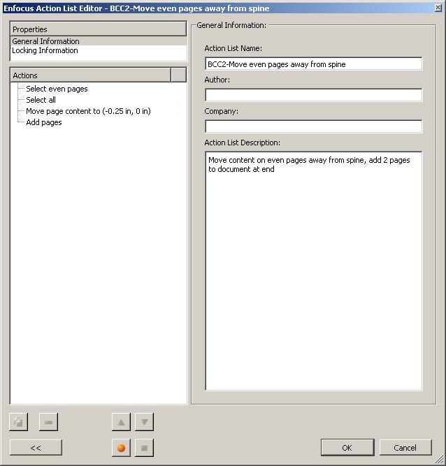

The Action List I used was created in Acrobat X Pro 10.1.6 and imported into PitStop Server. I believe that I have the select option correctly configured (see the capture) but Server moves the page content all the pages up .25". BCC Action List.jpg

abc was able to see what I was doing wrong. The actions that I had were:
Select even pages
Select all
Move page contents (-.25.0)
The "Select all" added the odd pages back into the selection. The answer was right there hiding in plain sight. Corrected list should be:
Select even pages
