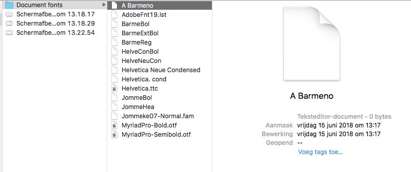

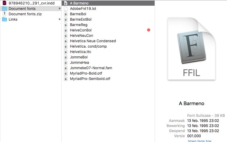

Thanks for your answer. What I meant is this: (please see attached 2 screenshots of the same Document Fonts folder, original, and once uploaded and download back again from a ftp server).
Notice how the icon changes to a 'blank' icon and the files are now 0 KB in size.

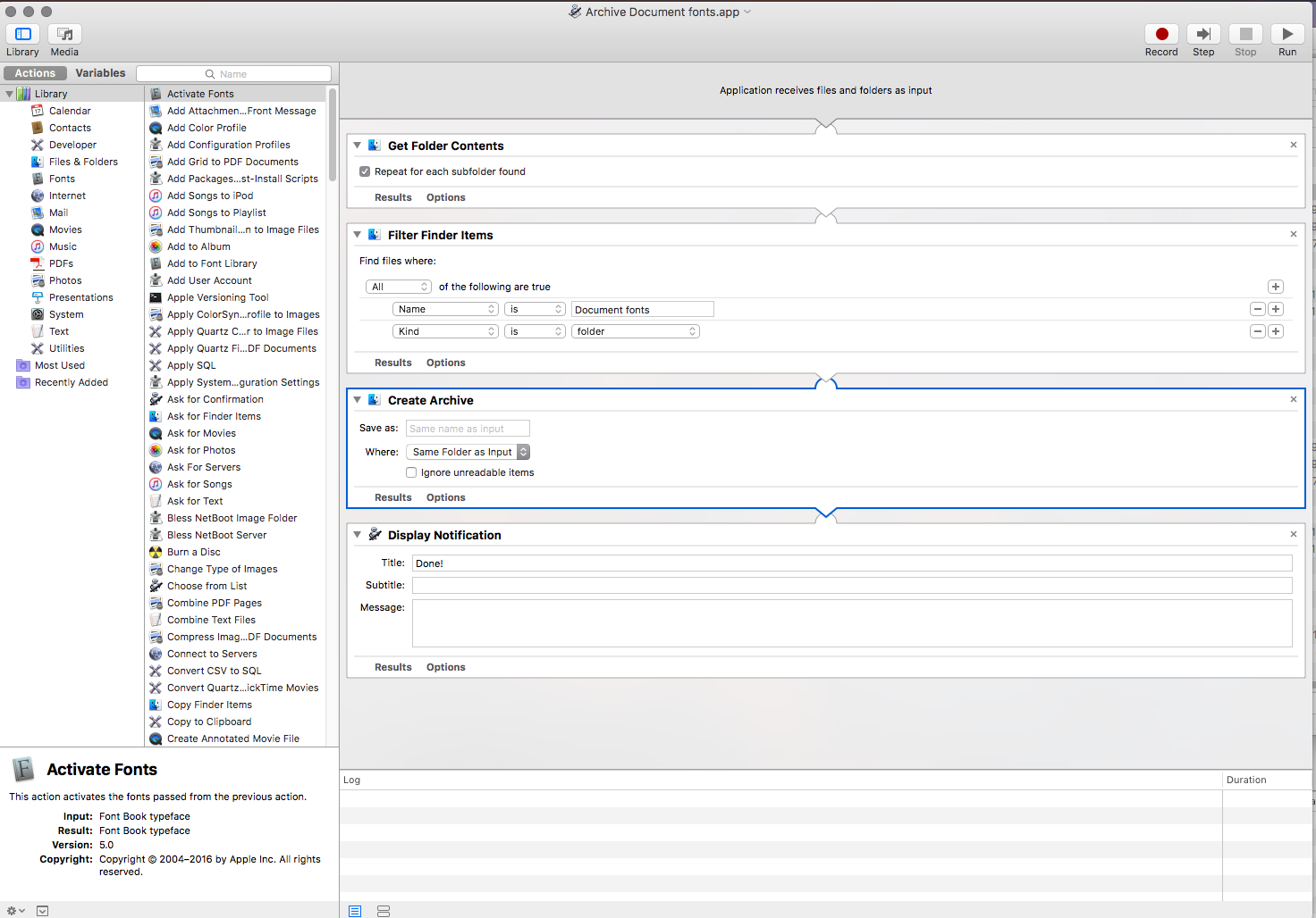

Hello Jonasukulore,
You can create an app with Automator on your Mac to do this.
I've attached an image of the workflow for you to copy.
