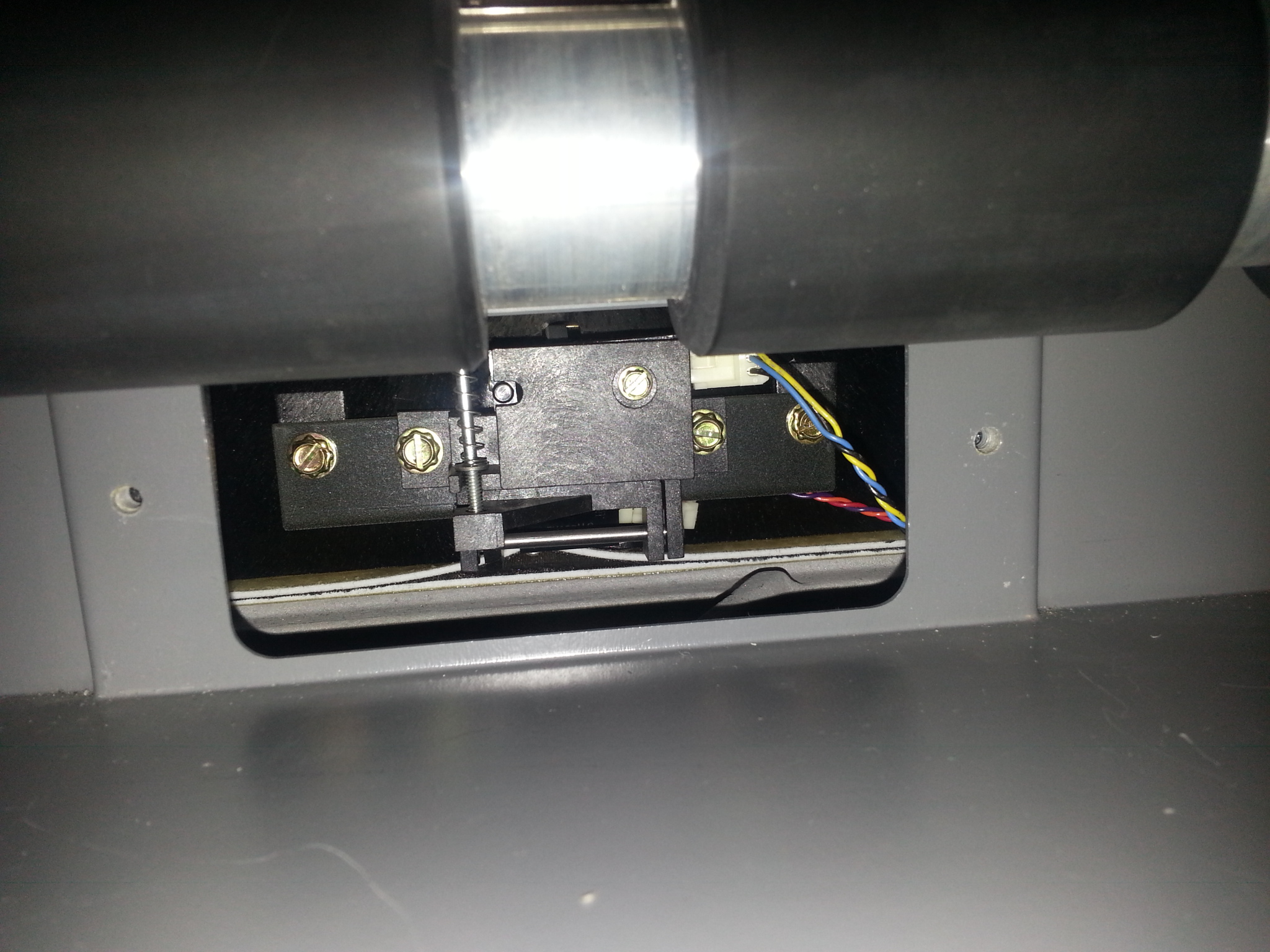

Again the problem appeared. The diagnostic program does not find any error in tests. But any action causing film forwarding stops with 62 error. Display Sensor menu shows the takeup Casette jam and media presence detector properly. We do not know what to do. Additionally we do not know how to dismount Supply Jam Sensor/Media Present Detector to check whether the wheel moves properly. Is it possible to disable the sensor?

thank you for the relevant pages of service manual. But there are two problems. First I still can not find out how to get into sensor and there is different mounting of sensor as described on Fig 5.30.
I have just made the Photo. It seems that it is not possible to take ou the sensor for checking without removing the platen above. 2014-01-23 08.34.34.jpg
