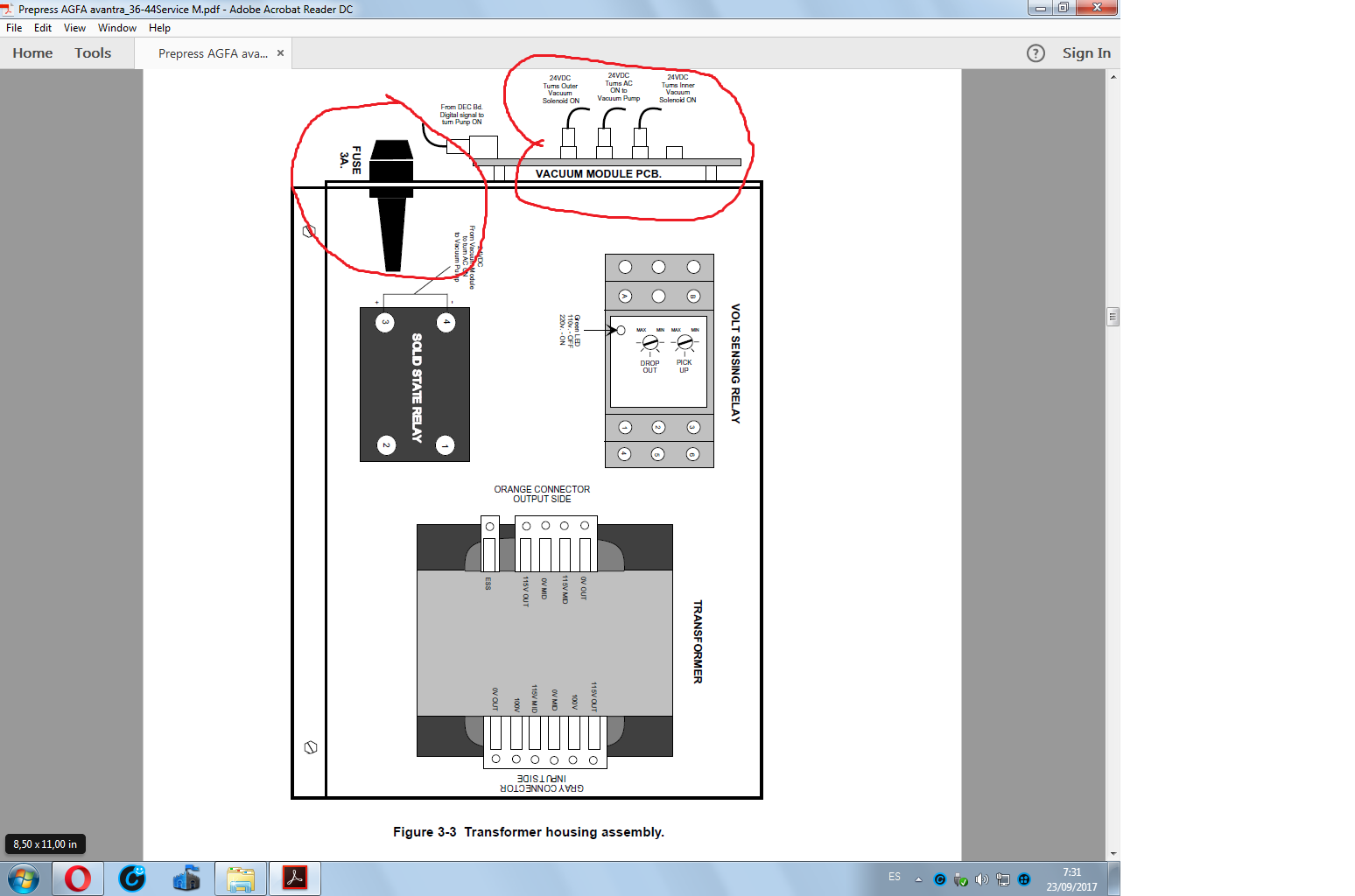

Hello everybody,
Please anyone can help me to know how many amps must to have the fuse for avantra 30 vaccum power?
I wanted to replace it but I found that the old one is missing.So I don't know its rating.
Thanks in advance.
Hi sir
Good day , attached is the screen shot for the fuse 3Amp FOR Vacuum
Let me know any question or doubt.
