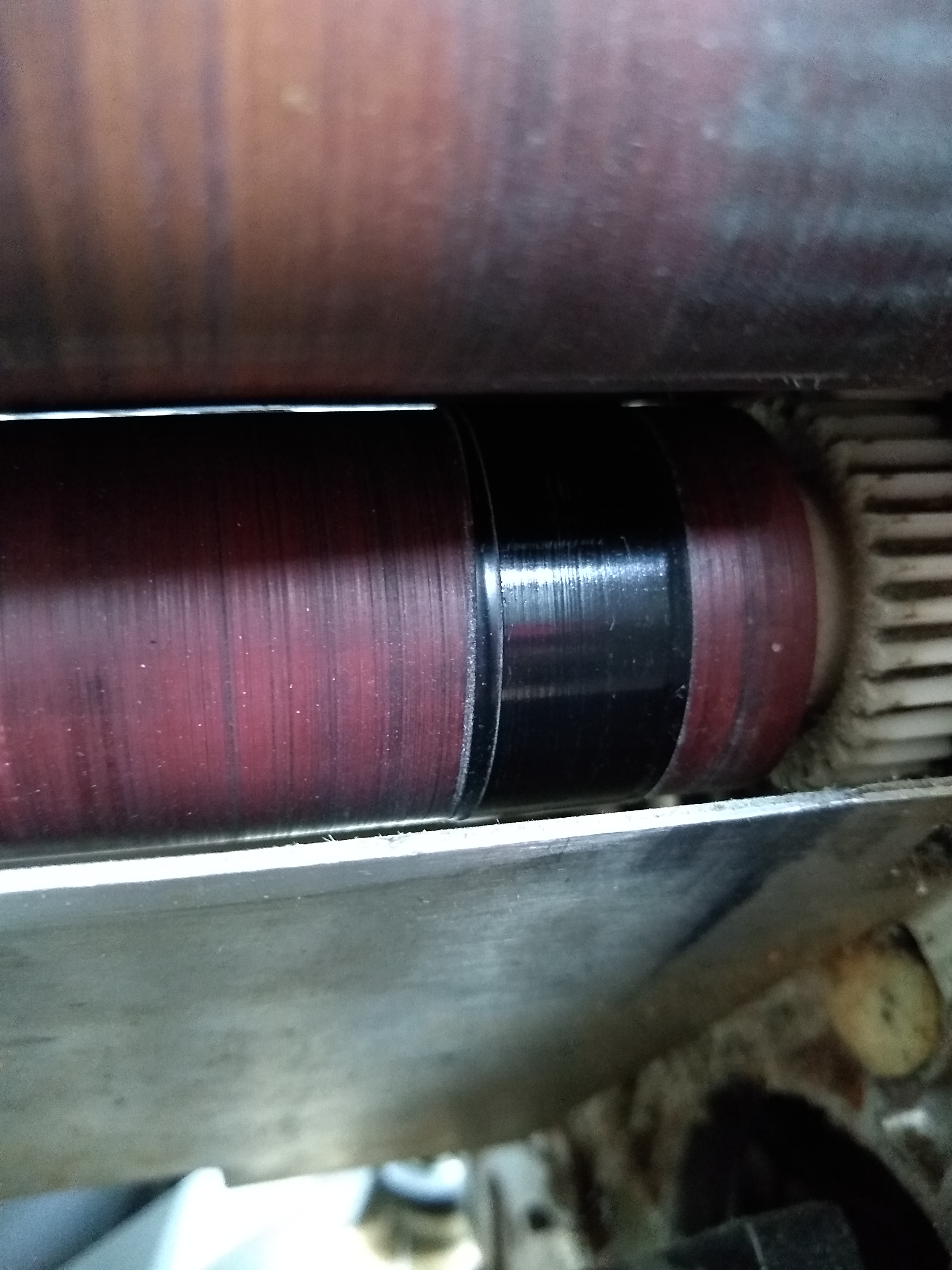

There is something you may want to try, it may or may not help. Your folder doesn’t have gap sets to separate the rollers for different stock thickness. I have an old friction folder that I use for heavier stock and 8 page newsletters that get folded. The exit rollers need to have a bit more gap and it can be accomplished by wrapping the ends of the rollers with tape to keep them a bit farther apart. You’ll still get that curving with heavy stock but if you pack them tight in a box it will disappear after a bit.
This photo is what I did with my folder to separate the exit rollers. I don’t use the folder for anything else other than the newsletters and the occasional heavier stock, so I leave the tape on. You’ll probably need to remove the tape after you finish the job. This is for half-fold only on the last plate.
The small circumference of the rollers is the main cause of the curl. The sheet has to make fairly tight turns and the thicker it is the harder it goes through the paper path. We bought a Horizon CRF for heavy stocks and the rollers are @4' in diameter. The tape will help, as will using the bottom plate but only so much. Good luck.

Thank you very much. I'll give that a try
Thank you. That makes sense.
