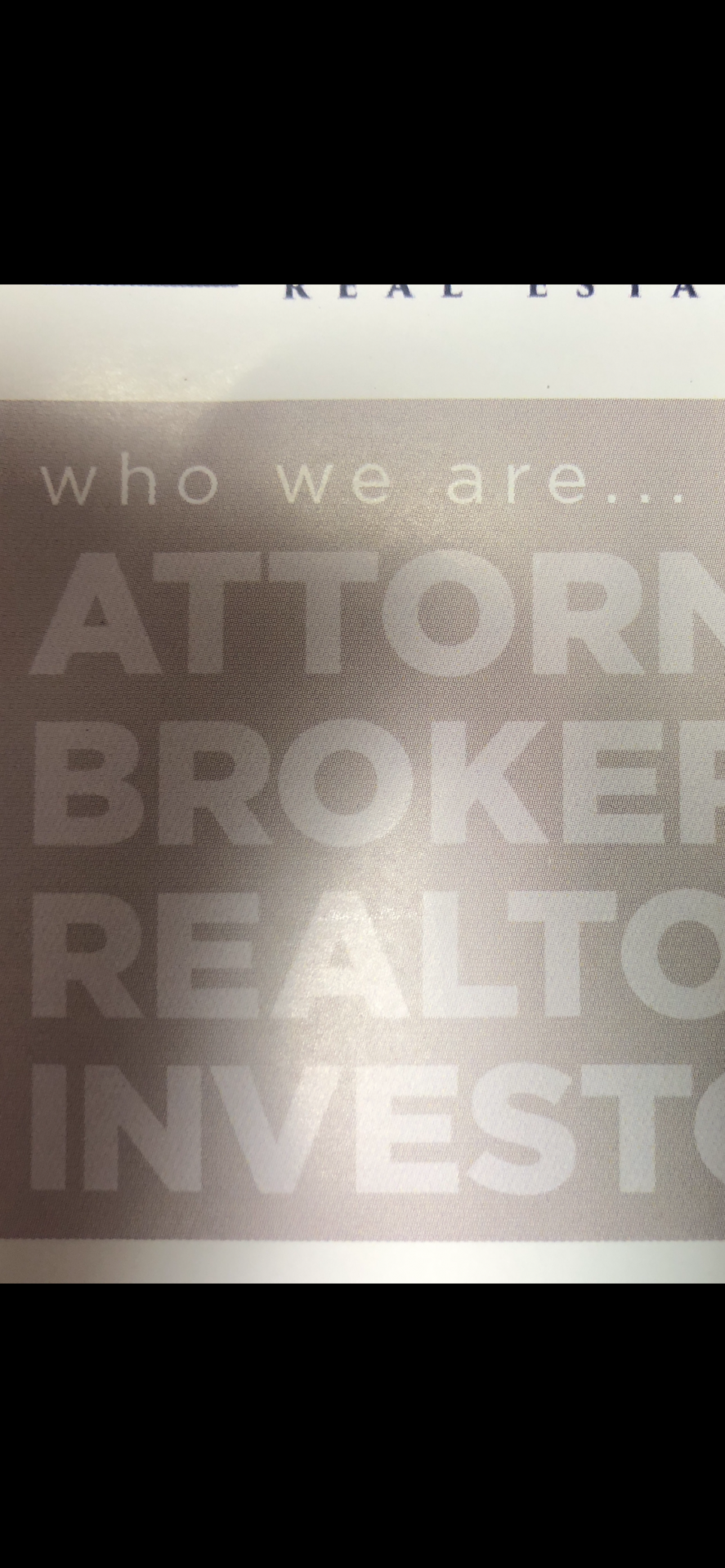

I know this is a really broad question but interested in getting some ideas. I'm trying to print a piece for a customer that is on coated stock with some light tan solids. I've tried a lot of combinations of settings and I'm not happy with the quality. I'm seeing a cross-hatch looking pattern on all of the solids. Does anyone have suggestion on how to improve the quality?

This is on 80lb coated stock. You can really notice the pattern I'm talking about in the light text.

Hmm is your dot pattern set weird? Do you have the ability to print some half-tone test pages and see if shows up on different papers and different files, and to see if the problem is isolated to only one color?
If it is a texture in the paper I would try creating a custom paper profile and setting the image transfer to 80%. If that makes it worse...then go to 120%.
A side note...your color separations appear to be misregistered. That's usually a service call issue though.

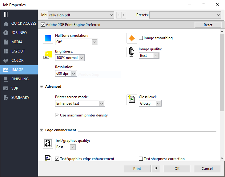

This should help. I think you have 1200 DPI enabled and maybe 600 dot or stochastic? If you set them back to what I have it should be the best "quality".
Edit: Gloss mode is something I use for certain jobs, it's not something I suggest as a default.

Thank you!!!! It looks really good now. Pretty much exactly what I was going for. Not perfect but I think it's probably about the best a J75 can do.
