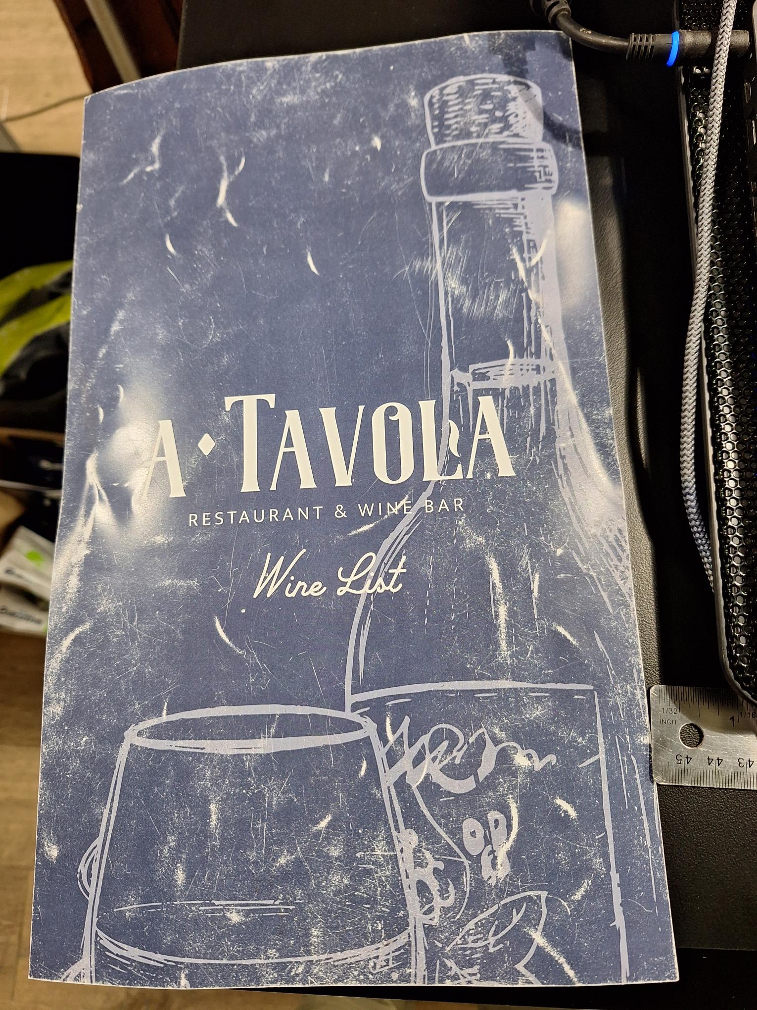

I also use MGX - 12mil Xquisite DT, to be exact - and I'm having an issue with the toner rubbing off after a few months. Do you find this to be true on your end? This menu was printed in August. Granted its handled quite a bit but gees!
